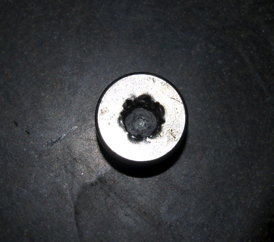

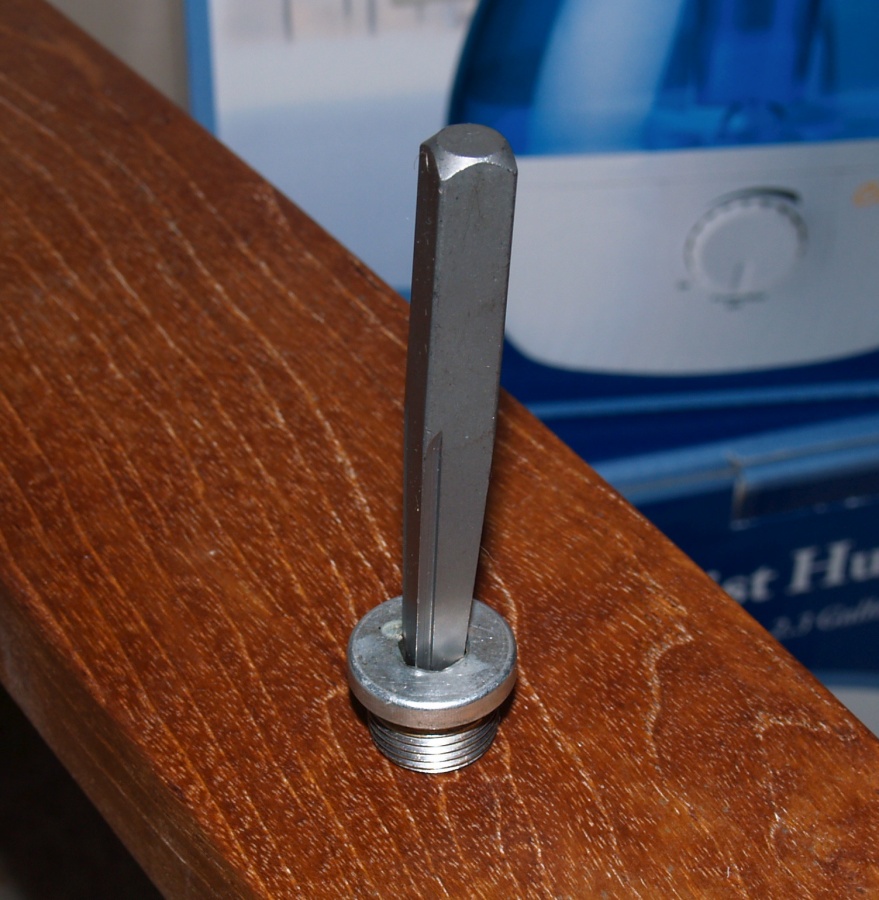

I would suugest using a hex bit rather than a Torx bit to remove the soft aluminum drain plug.
The drain plug is a metric hex bit. Using a proper bit (instead of an Allen key or Torx bit) will prevent stripping the plug.

Originally Posted by bbywu
Great write up.
Correct, 8mm Allen bit.
Consequences of using the wrong tool for the job:
Great write up.
Actually I have the hex, Porsche told me torx and 2 write ups on renntech said the same. When you look in the hole you can see the extra torx slots.
Def torx in my case
