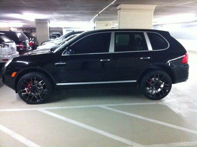

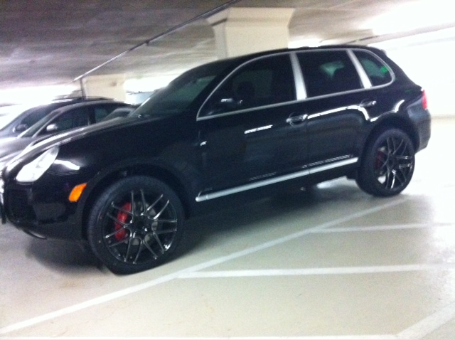

Picture od Wheels
Ok Wheels are on , I just snapped 2 quick pictures. I ordered from Ebay the black porsche center caps and they dont fit! they where to big so any ideas on where to get the right size for these wheels?
I think they look supper cool
