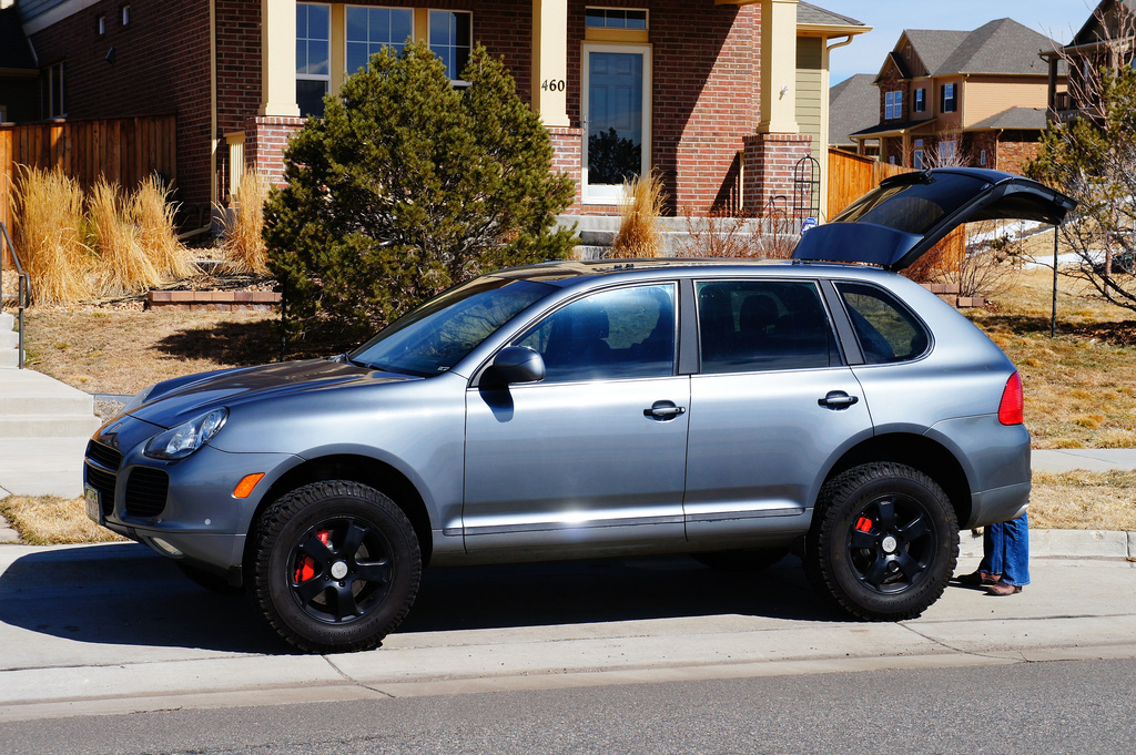

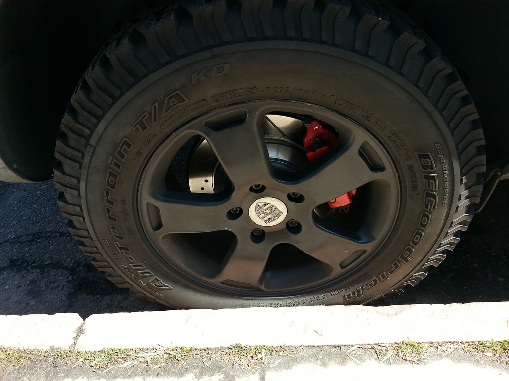

265/65/18 BFG AT
Since nobody else seemed to actually try this on a Cayenne I figured I would dive in now that my winter tires needed replaced!
They are tight when turning, but clear at the normal height setting. Just graze the fender liner on the turbo at the low setting(turning, clear fine straight)
The contact on the low setting is literally just a super light dusting type contact. It would also be very early to just trim out the fender liner for an even bigger tire.

First Turbo I have seen.
I have been through 2 sets of AT tires on 17's
Just ran 265/65/17's that broke the steel belts.
Running 245/65/17's now Hankook ATM's.

Man i really like how that looks

Cole That looks good

Thanks!
Just a few comments.

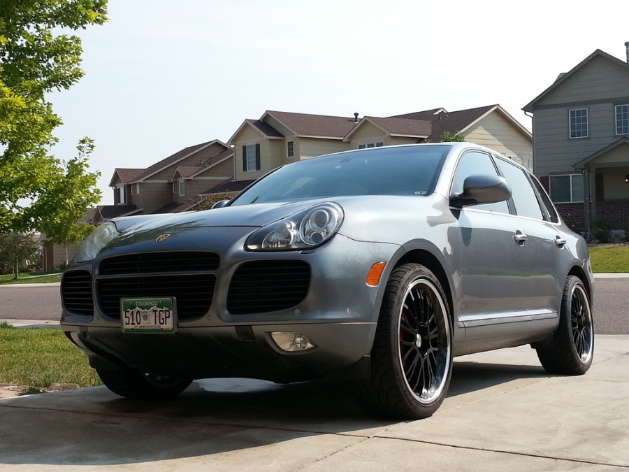

My AT Italia winter wheels stick out just slightly more than stock 18s so there would actually be more clearance with stock wheels.
After driving it around today and looking at it several times. I can say that it really does add a tough, bad ***, off road type look to the CTT. I really need to get a better picture than the one above.
Makes it feel like a proper SUV for the winter!

Snapped a couple of comparison shots today sitting next to a steel spring S in a parking lot.
My CTT is in the first setting above the normal ride height. It will stay in this setting up to 50mph which is 95% of my around town driving so it jut ends up staying there.

lol looks like a stomper!! No rubbing? NOw all we need is 3 ft of snow!

Zero rubbing.
