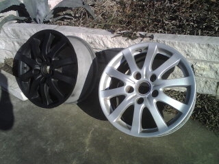

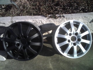

well good for me then, I just picked up 4 unused OEM 17 with TPMs FOR 200 BUCKS. Im about to go outside and pressure wash them, sand them, then spray them with a matte or satin black finish..........

finished this on Saturday

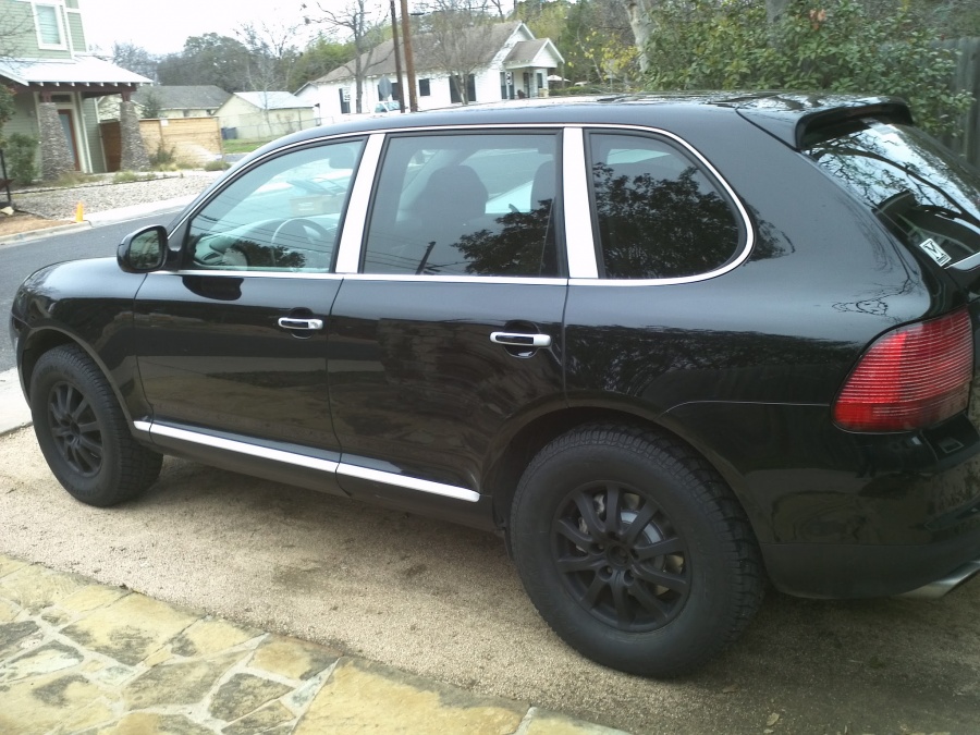

first day trial
Tires on the wheels...not mud terrain though.

The Transsyberia rally Cayennes ran 265/65/18. In the close up pictures there seems to be no body modifications made to fit these. Many of the Touareg guys run this size for their off road tires! Basically a 32x11 tire.
I'm looking for a set for my 18s for a winter and towing/Offroad tire.
I personally would prefer the look and feel off the typical mud TA over an All Terrain tire. You may only use it 1% of the time, but I'd prefer not to be stuck during that 1%.
I'm working on a front rally style light bar for the front of mine if anyone is interested.

I stand corrected, these are actually 265/70/17......I was not paying attention when typing.
I ran them after a weeks long down pour here in Texas on some clay roads, fields, and thick mucky shoulders/drainage ditches.....psm helps and the extra grip and rip, they didnt really slip on the road one bit. Poor 2500 and 3500 diesels were slipping and having to tear up the shoulder at the Wildlife management area.
They also did fine trudging through a field.
I would would love to get some Mud terrains, too hard to drop 800 bucks after this xmas. I am actually liking these more than the 22's??!!! We shall see in a few months of I want to get back over.....but I like busting through pasture and running over potholes again with no worries.
I saw an older range rover with some 15's or 17's carry skinny mud tires...looked good.
