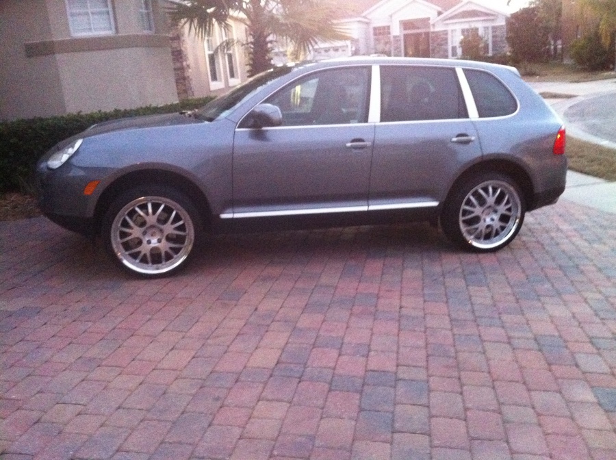

Going with the 265/35/22. Should be on the car tomorrow

Post some pics when you're mounted up...I'm curious what it will look like.

Wheels are on...

Any close up pictures? Wheels look nice!
