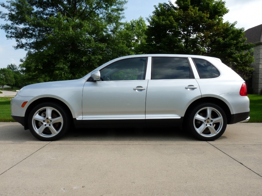

I have OEM 20" Porsche Sport Techno wheels on my Cayenne S. I generally keep the PASM set on the "low" position, and this really does a nice job of filling out the wheel wells with the 20s. As far as wife comfort, I keep the suspension set on "normal" and it's pretty cushy. You can also put it on "comfort", but I find this to be a little to soft. The other setting is "sport", but this makes the ride really rough. Even more than the 911.
As for tires, I've ended up going with a *gasp* non n-spec, all-season radial. I use the Continental Extreme Contact DWS. I like it much better than the OEM summer-only Contis, both in terms of tread wear and ride quality. I think the set was roughly $1,200 installed, which is pretty good. I'm hoping to get 30K miles out of them.
In the photo below, my Cayenne is in the "loading" position, so it's actually just a tad higher during normal driving.
