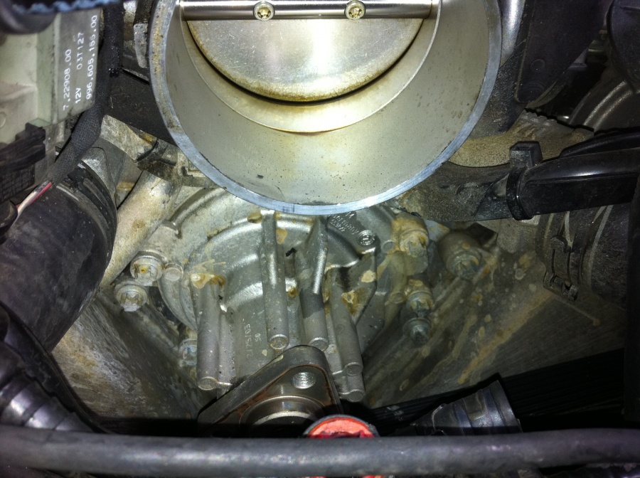

Pics of water pump on 04 CTT
Thanks for the great write up. I thought I'll post a couple of pics. Only thing I did different was not removing the right and left large coolant hoses. First time replacing the water pump since brand new, now have 150K miles! Yes coolant pipes been changed twice to aluminum ones and the T connector been changed, all by Walter's Porsche.
Did not fill coolant through the hose
I did not remove the big hoses, therefore did not fill the coolant through the radiator hoses. Well, now I can't fill the system with coolant. Any suggestion or do I have to backtrack and fill thru the upper radiator hose?
Don't know, but I hear it's a PITA to burp a Porsche. Would be good if you post the resolution here. If you took it in for a coolant flush, it would resolve your problem: I bet a dealer wants $200. I wouldn't let JiffyLube or some drive-in quickie touch it. I'd try going back in through the hose and see how much you can get back in the radiator. At least you don't have to take the pump off. You should be able to take off the plastic shrouds and right side of the air hose to throttle body to access the rad hose. Fill into the hose, not the radiator. Do all this with a cold engine, then drive it and check level at fill tank. Good luck.
