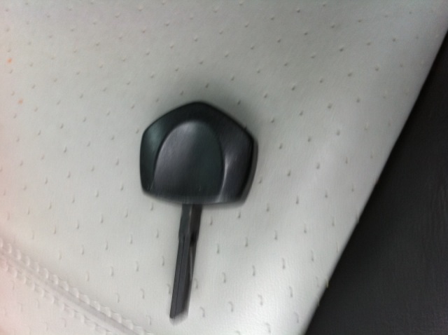

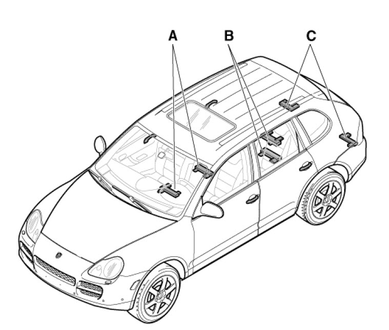

You still have to turn the dummy key to start the car: you insert it like a real key, and it clips in and stays there. It's truly like a plastic uncut key, but not as large since there are no transmitters -- simply something that fits in the cylinder and turns to fire the ignition.
But when you turn it, the KESSY system kicks in looking for a real key, somewhere in the car. Apparently the interior sensors in the car are under the front ashtray, front cupholders, backrow middle seat somewhere, and maybe even trunk.
Here's a pic of the key (I googled and it brought up another 6speedonline thread):

Originally Posted by tooch
Okay so I have an '06 CTT and I don't have to unlock the door either but I don't have any plastic key . Where do you get the dummy key at ? Or is it key for the dummy {me}
I didn't have one either, so I called Sunset Porsche, and $16 and two days later, it was in my mailbox.

Sensor locations, courtesy of Mudman2!
