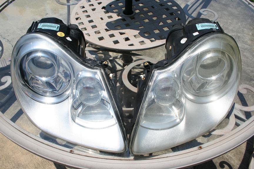

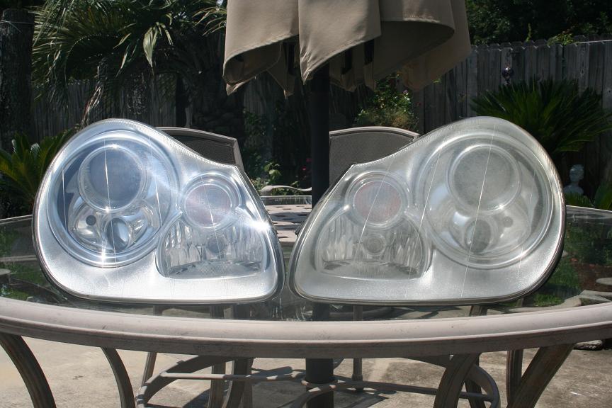

I refinished my headlight lenses. Attached are some pictures. Below is a list of the products used to do the restoration. The rubbing compound and the polish were applied by a buffer, but the rest was applied by hand. Total time was around 4 hours.
List of Products:
600 grit sandpaper
2000 grit sandpaper
2500 grit sandpaper
3M super duty rubbing compound
Meguiar's PlastX Cleaner and Polish
Meguiar's Headlight Protectant

It sounds like a lot of work but it looks good.

I did mine a little while back with the 3m kit. Lots of sanding!! But the lights were much better when done.
Here is a pic from half way through the process. I got a little extra carried away and painted the inside trim piece of the lights. You can see in this picture the left one done and the right one is stock still.

i did the same thing with the 3M kit. but noticed some blur on the inside. did not want to bake the housing open so was a little disappointed with the results.

Originally Posted by Boxzing
Very nice. Do you think those headlight cleaning "kits" can produce those same results?
I'm sure the 3M professional kit will. Its like $350 though.
I ended up taking my headlights out and sitting it on a stand in the garage to do the work.
As far as the haze inside. Yes, mine still has a haze on the inside when you get up close. I believe it is from the heat of the xenons causing the plastic to expand. Could be wrong though. It almost looks like tiny spider webs on the inside.
