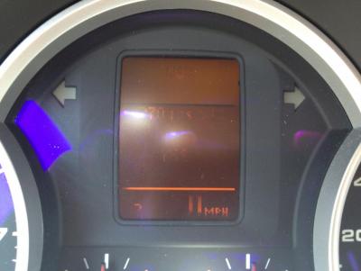

Personally I believe the fading problem is twofold. The multi-function Mono Chromatic LCD display screen (or driver information display) is going bad, and the LEDs behind the display that illuminate it are also going bad. If problem includes the LEDs, this repair might fall out of the domain of DIY due to the leds being soldered to the main board. If it only involves the screen, then we are going to save ourselves a lot of money when compared to replacing the whole cluster.

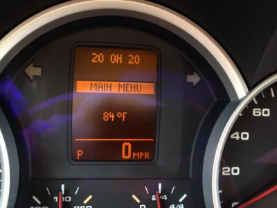

Daylight shot of my screen before it completely fades away with the heat.
Night shot of my screen with fading beginning to occur. Kind of blurry, but you get the gist

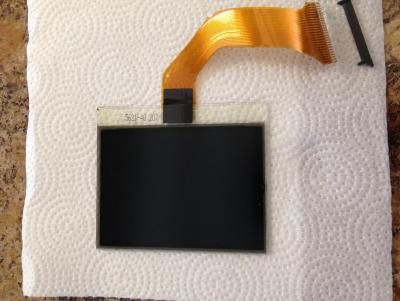

Since I did not want to experiment on the cluster in my 2006 Cayenne S, I purchased ($170) a used cluster off of eBay to tear apart and figure out how it works. The actually disassembly of the cluster is quite easy as it only involves torx bit screws. The LCD screen is NOT soldered in place and the ribbon connection is held to the main circuit board by a plastic piece that puts pressure on the ribbon to keep it in contact with the cluster circuit board. The screen is held in place by a metal bracket that clips into place.

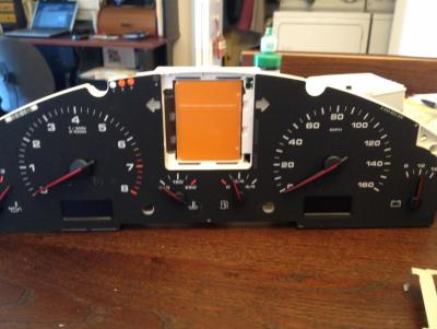

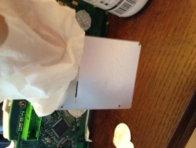

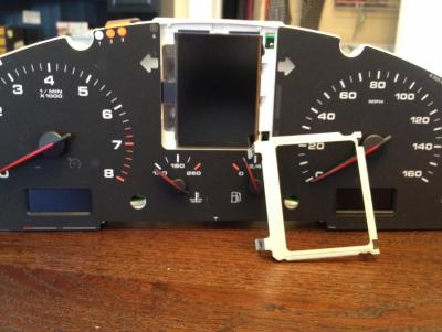

Picture of the Cluster with front casing (glass dial covers) and back casing (just a white case with port holes) removed and LCD retaining bracket removed.

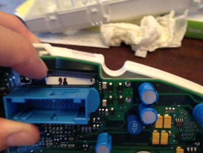

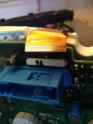

I removed the metal bracket by depressing the legs with a screw driver and pulled the plastic retaining pin on the back of the cluster out in order to free the ribbon connection. The ribbon from the screen is partially behind the black dial face and snakes over the top of the cluster to the back circuit board. Next I carefully lifted the LCD screen out of place. I noted that my screen had the following numbers printed on it with no quotes "5621-40 207". I have googled the numbers hoping it was a part number, but I did not find anything. It appears this defect occurs more often in warm climates. This cluster came from a cold climate and had around 35K miles on it. I held the LCD up to the light and all the pixels appeared consistent. This might be my last resort if I cannot find a replacement screen.

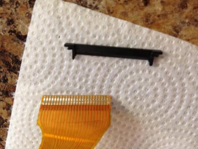

Connection for the LCD ribbon and the ribbon from the LCD screen that slides into in the circuit board on the back and is held in place by a plastic piece.
End of LCD ribbon and the plastic connection piece. The handwritten number was already there when I opened her up.
Ribbon plastic piece sitting on top of the circuit board connection, with the ribbon removed.

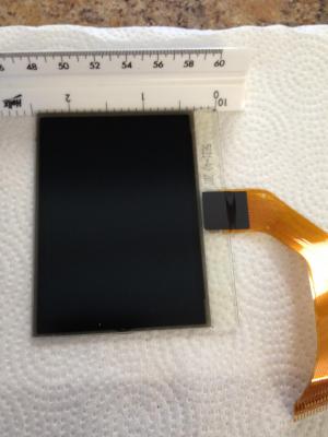

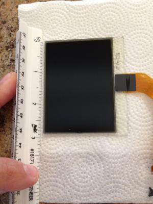

Full Shot of the LCD screen.
Height in inches
Width in inches

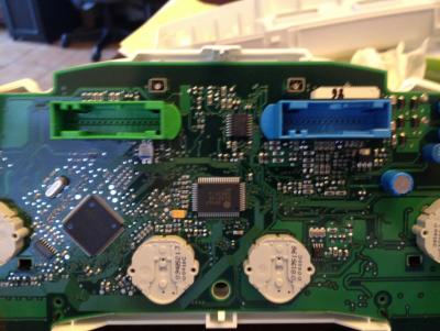

Back of the cluster. The white boxes contain the gears to turn the needles. Notice the white ribbon connection point above the blue terminal.
In regards to the picture above, I have come across the replacement transformers for the instrument cluster that repairs the failing LCD screen when searching for parts, but I have no idea where they would go or be placed. As there is nothing that "Fat" on the circuit board. It is very thin, and the biggest things attached to it are the gear houses for the needles.

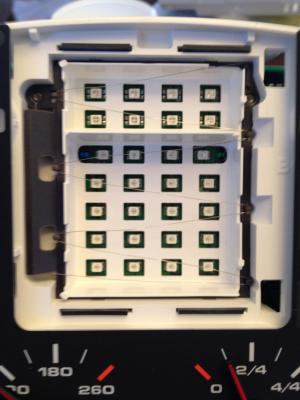

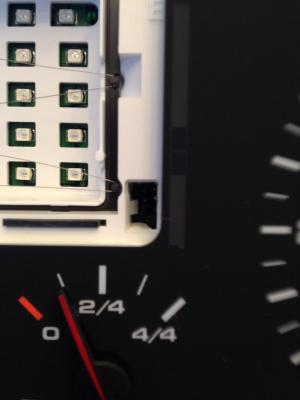

To access the backlight LEDs there are two filters that you have to remove. The first one is colored orange and the second is white. Do not touch these with bare fingers as the oils on your hands stick to them and cannot be removed.
Orange filter that sits underneath the LCD display. There is a plastic bar that creates that nice separation you notice in the display. The filter fits into a cut out slot. The white filter is beneath the orange one.
White filter removed.
Notice how the box is separate into two distinct areas. Those little rectangles are all LEDs.
This picture shows where the leg of the metal LCD retaining bracket would clip into place.

I happy to report that the problem with the fading LCD screen is due to the LCD Screen going bad and not the transformers or leds. I swapped my screens out this past weekend, the results were flawless. It can be done! The new screen came out of a brand new Cayenne S cluster that was bought by a company for parts.I got lucky enough to get my hands on the screen to try this out. Hopefully the new screen has better longevity in the hot Florida sun that I live in.
Before...
After...
