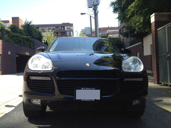

Just wanted to shared what I did this weekend. Enjoy! 2005 CTT
This is exactly the look that I want! The grill is exactly like mine except mine is colored silver. I know the pix and install details are coming and would really appreciate that.

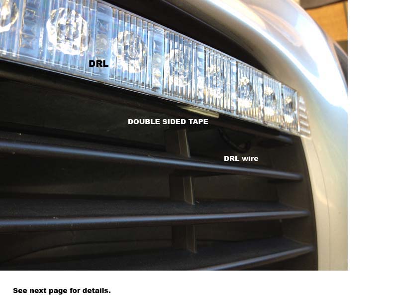

Just a few questions for now which I hope you won't mind:

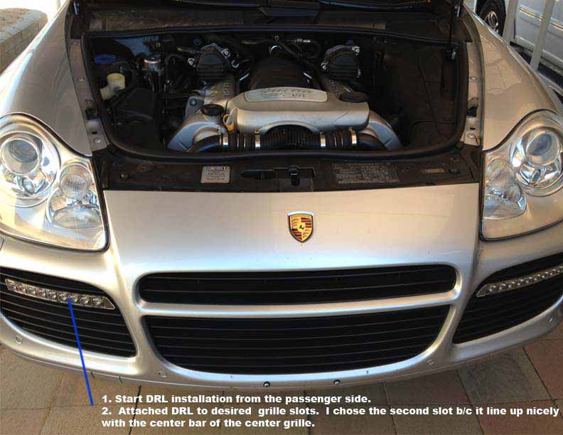

1. Why did you mount the DRL's on the 2nd slot and not on the 1st slot right below the headlight assembly? (It looks better for you or there was an obstruction in the rear part?)
2. Isn't 10 minutes too long before the DRL's turn off? Is that the ideal / recommended way to install them? Is there any other way of wiring them? Does the DRL package come with an install diagram?
2nd slot seems to fit well. 1st slot is not long enough because of the curve.
I strapped to the side marker. Thought that's easier but may not be the best solution. So far it's working fine.

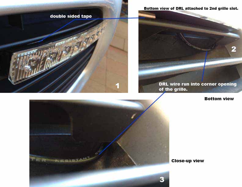

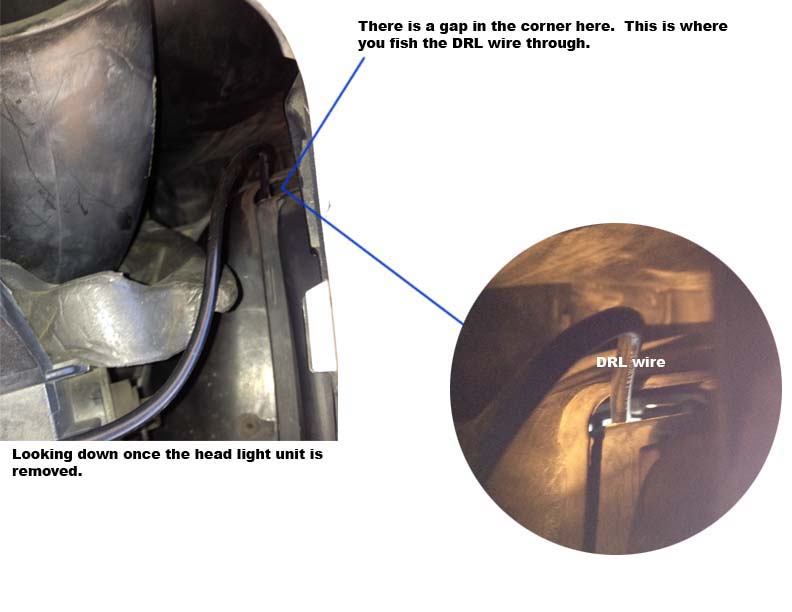

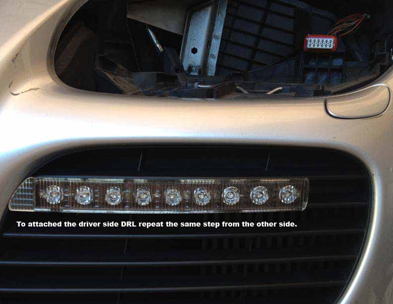

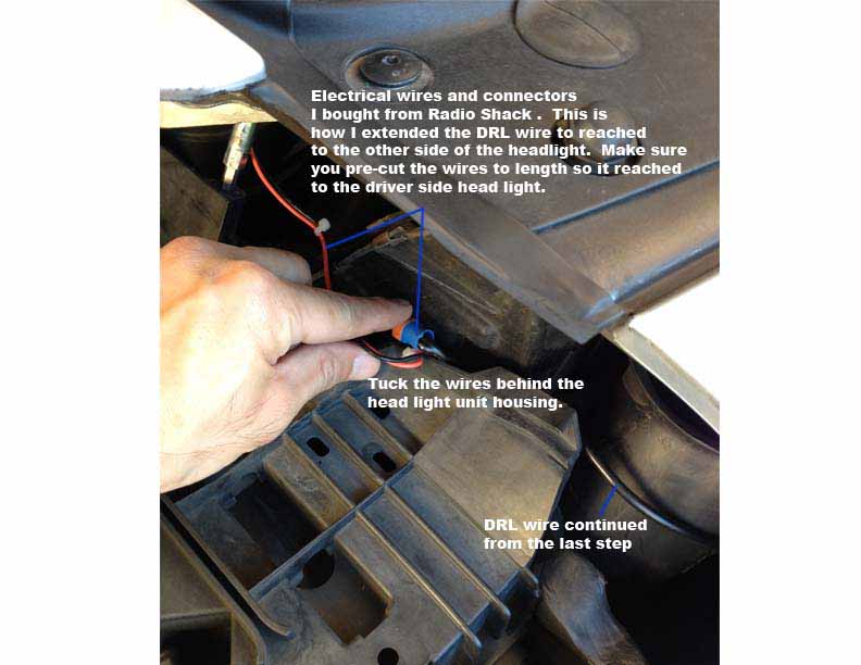

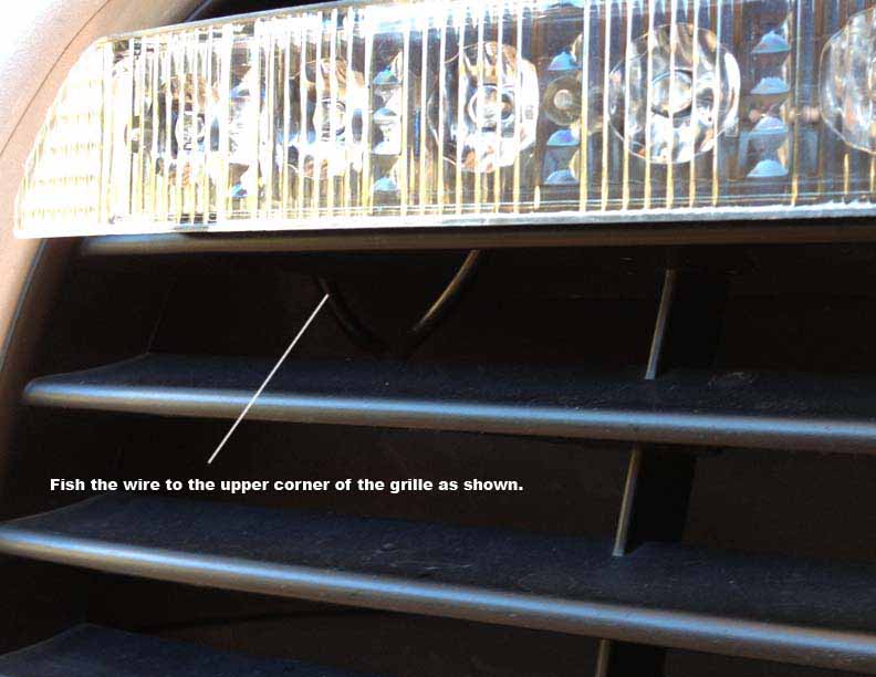

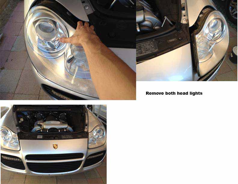

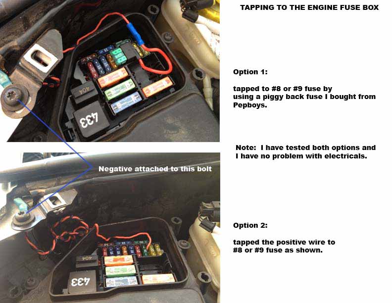

1. I wanted to line the DRL with the center bar of the middle grille. I think its appropiate and right. A car designer in me wanted to keep all the lines cohesive.

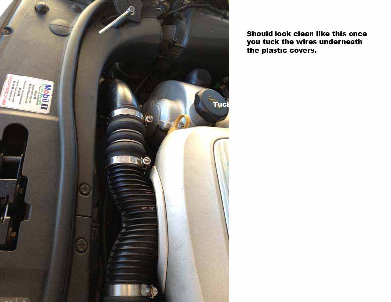

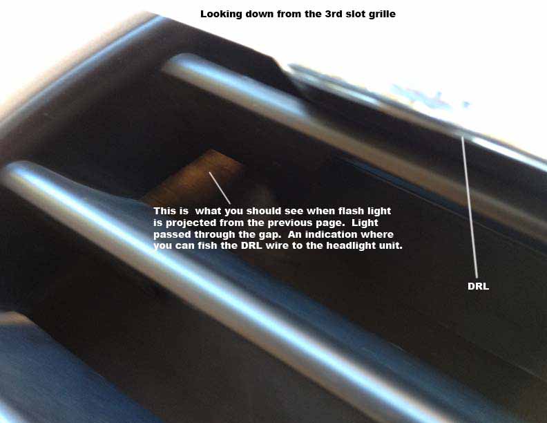

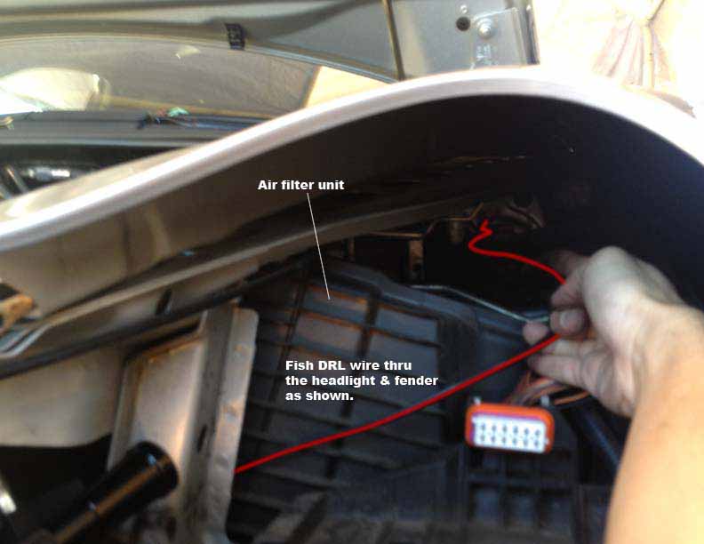

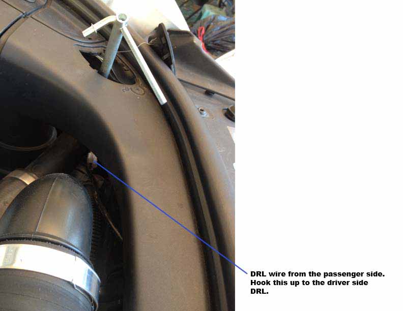

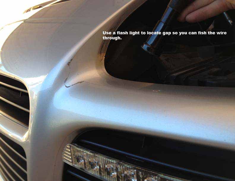

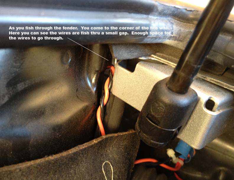

2. 10 minutes is a little long. But it's an LED. It hardly used that much juice. When you hook up to the side marker, does the DRL turn on alone when the key turn or you have to turn on the parking light for the DRL to work? In my case the DRL turns on when the ignition is on.

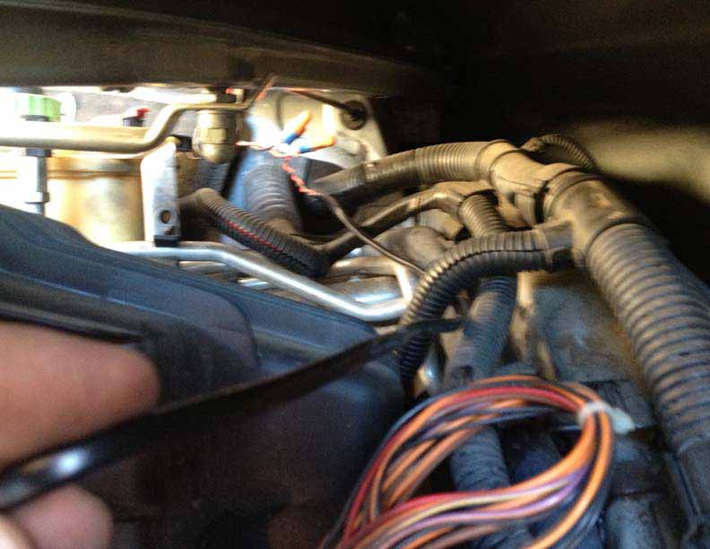

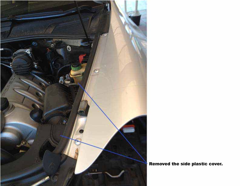

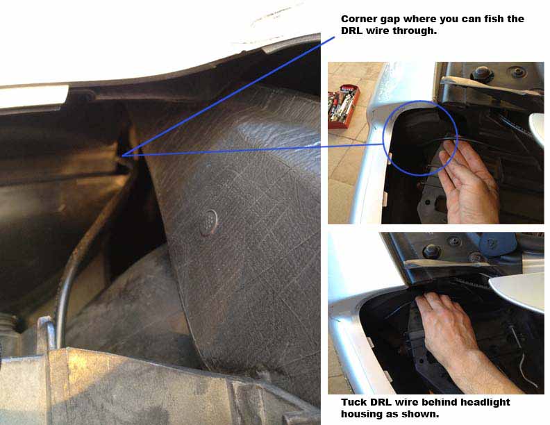

As promised...I had put an images of my wiring. This is not a full DIY but it will give an idea how to approach installing this kind of DRL. As long as it helped the community in some way I'm glad I can be an assist to some.

continue...

continue..

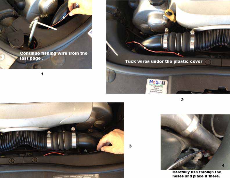

Originally Posted by bansasn
continue..
A few more steps.
Old Jul 21, 2012 | 03:03 AM
bansasn's Avatar
Joined: Apr 2012
Posts: 212
From: San Diego
bansasn is a name known to allbansasn is a name known to allbansasn is a name known to allbansasn is a name known to allbansasn is a name known to allbansasn is a name known to all
A few more steps.
And finaly the last step. Enjoy!
It was very simple. The light comes on when ignition is turned. No flip switch. I wired to the engine fuse box. Fuse #9 by using a piggyback fuse tap I bought from Pepboys. I wired the ground to the bolt next to the engine fuse box. The light turn off by it self 10 minutes after the engine is off. I think the DRL was proramed that way for short circuit purposes. When I get some free time I'll post pictures how I ran the wiring without drilling.
Thanks for this info. But is there any other FUSE in the engine fusebox which has an IMMEDIATE OFF when the ignition is switched off? Can you route a piggyback fuse setup to the inside driver side fusebox. I think there's an ignition activated power supply there ...? (not sure)
I have tried every fuses in the engine fusebox and I still get the same result. I am aware there is an ignition fuse in the interior fusebox. But I want to avoid drilling the fire wall. I don't think it's worth the effort to drill a $50K+ vehicle for a small thing like this. I have installed another DRL to my Prius. The difference is that the light is always on when the positive is connected to the fuse or piggyback to a fuse. To avoid this I hook the positive wire of the DRLto the relay fuse unit. By connecting to the relay the DRL for the Prius turns off and on when the key are turned. Having said that...I think the same principle can be applied to the Cayenne if there is a relay in the engine bay area. I personally have no problem for the DRL to turn off later. The LEDs hardly used that much juice compared to a regular bulbs.
