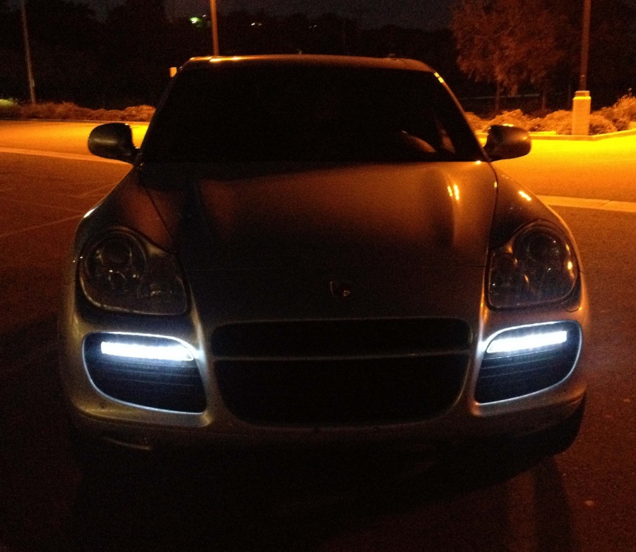

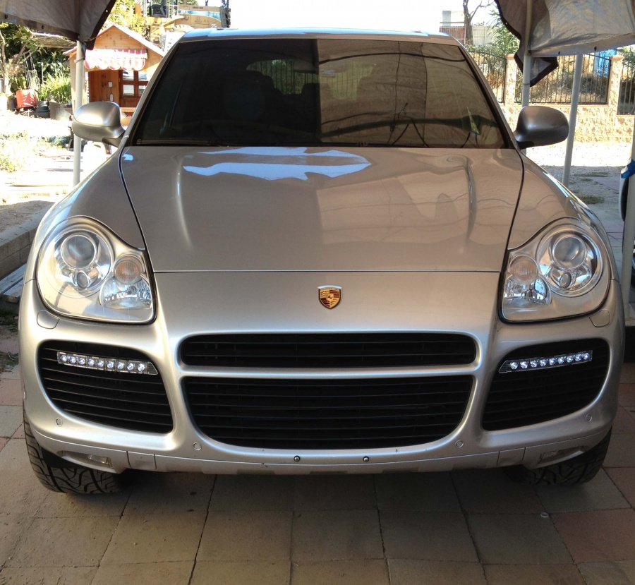

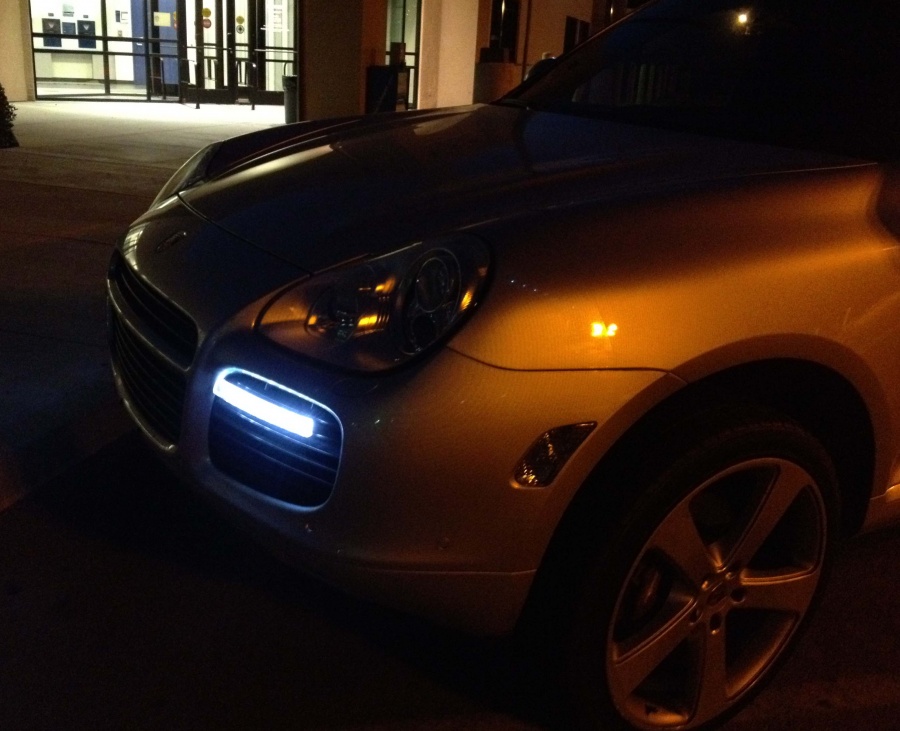

Just wanted to shared what I did this weekend. Enjoy! 2005 CTT

interested in a little more info- whos product did you use, ease of install, etc...
looks good though, one of the better versions I have seen on a 955.

Are these the phillips LEDs? they look larger (wider) and seem to fill out the grill nicely

Looks good...almost like my 957.

Thank you everyone. This was the DRL I used.
http://www.ebay.com/itm/HELLA-STYLE-SUPER-WHITE-LED-DAYTIME-RUNNING-FOG-LIGHTS-/280905323336?pt=Motors_Car_Truck_Parts_Accessories &vxp=mtr&hash=item4167431348
I thought about getting the Philips LED as well, but it was not as wide as I wanted and way over priced. The only modification I made was sanding the edges so the shape flows nicely with the shape of the grills. As you can see the differences between the original design and mine. It was a 5 minute sanding.

It was very simple. The light comes on when ignition is turned. No flip switch. I wired to the engine fuse box. Fuse #9 by using a piggyback fuse tap I bought from Pepboys. I wired the ground to the bolt next to the engine fuse box. The light turn off by it self 10 minutes after the engine is off. I think the DRL was proramed that way for short circuit purposes. When I get some free time I'll post pictures how I ran the wiring without drilling.

Very nice, almost looks stock, how did you attach them to the grills?

I installed the same DRL bought from ebay. I used double side tape, top and bottom, and push them into the grills. They fit just well, the grills expanded just a bit like few mm. I will post pictures when i get a chance.
