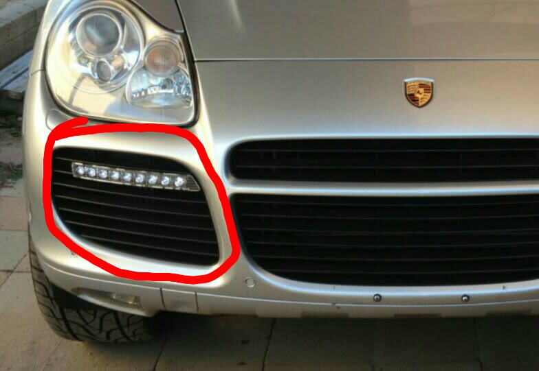

Im planning on modifying this part of the front grille specifically the 2nd slot so that the DRL will look more OEM. Planning to have paint putty, do a sanding job and repainting it. Can you remove this front grille without removing the whole front bumper?? I dont want to trigger the airbag as well meddling with the front bumper. Any ideas? Or do I just pry off and pop outthis grille? Tried to pop it out but thereare clips at the back which are not accessible.

I always pull the airbag fuses before playing around with bumpers havent done it on the PIG yet but a quick search should show you the way, btw drls look good.

Yes you can just pull out the grills only. I always do that easily. Just pull with appropriate force.
