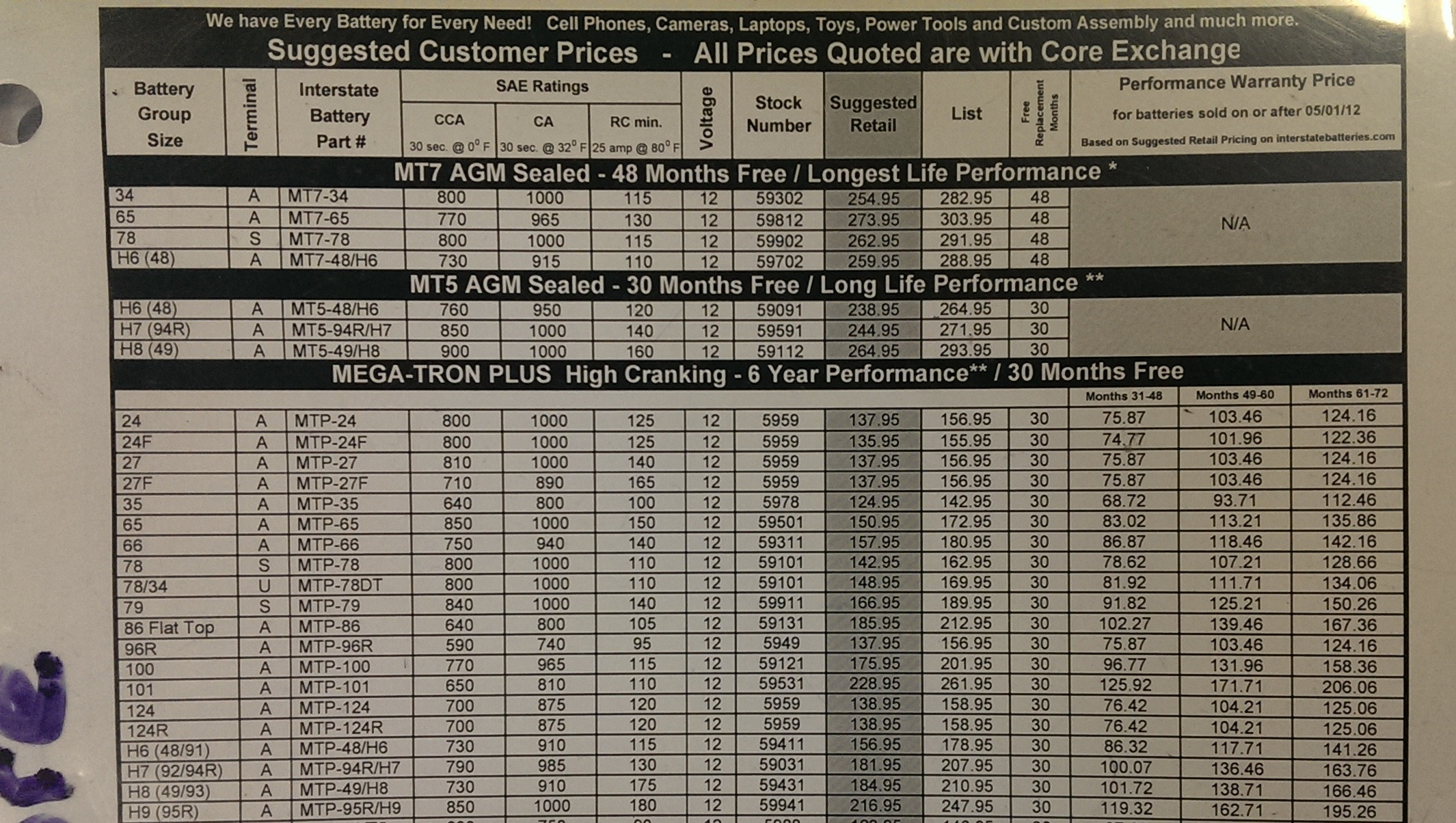

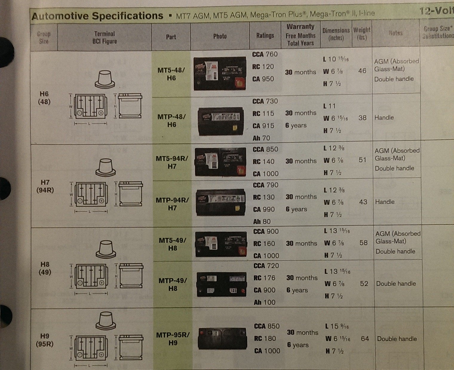

H9 (95R) battery group size
Just want to add a few details to this great DIY. First off, I don't know how common it is but my 09 CTTS has one battery under the drivers seat with a 110 Ah capacity, corresponding to the JOZ (or is that J0Z?) option code (850 CCA). After much research, it is a H9 (95R) group size which measures 15 9/16" x 6 15/16" x 7 1/2" (L x W x H). None of the local auto parts computers list H9 (95R) as a compatible size, only the smaller H8 (49) group size with correspondingly reduced 100 Ah capacity (730 CCA). If H8 is indeed the "normal" battery size for most Cayennes, I wonder if the larger battery would fit since the width and height are exactly the same, so the hold down clamps would still work. Potentially easy mod that others can chime in on if they are replacing a smaller stock battery.
For those in the Los Angeles area, Interstate Battery in San Gabriel carries a direct OEM replacement for $217. Here are their spec and price sheets (H9 bottom rows).

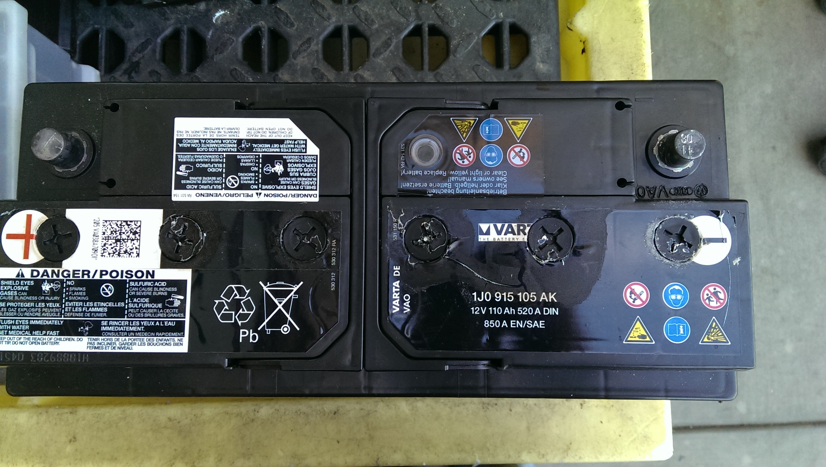

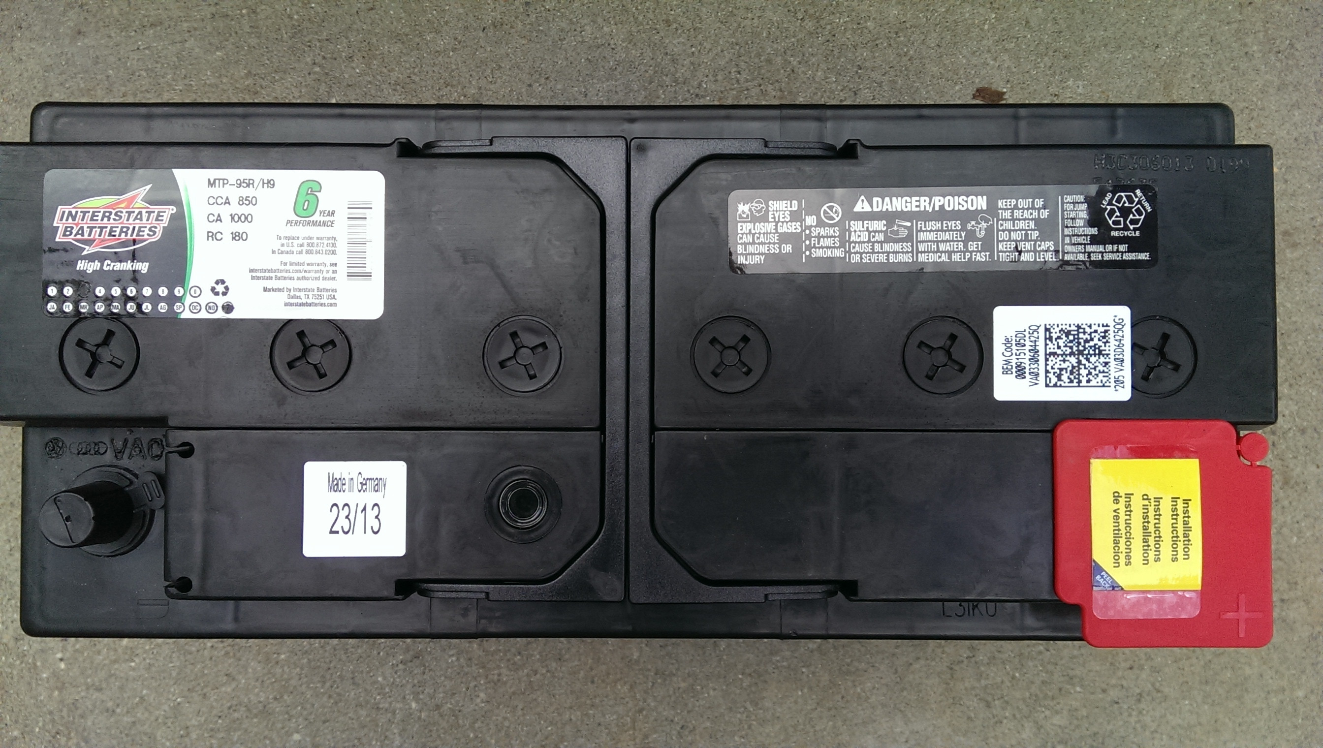

Here is the old battery compared with the new German-made one from Interstate. Exact match, down to the VW/Audi stamping by the negative terminal.
