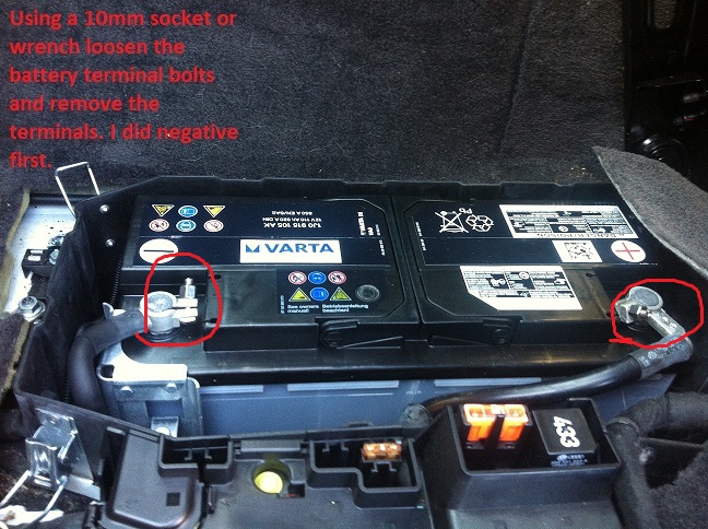

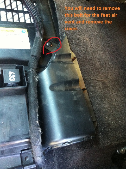

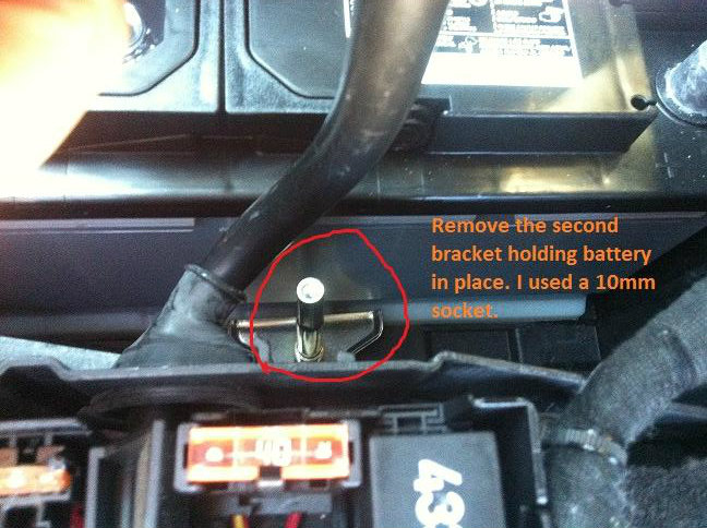

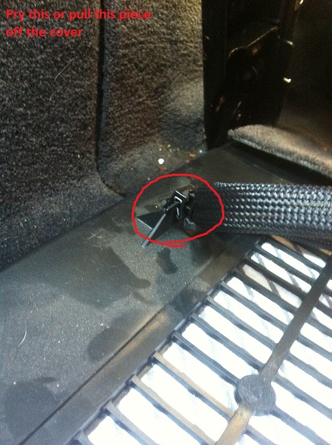

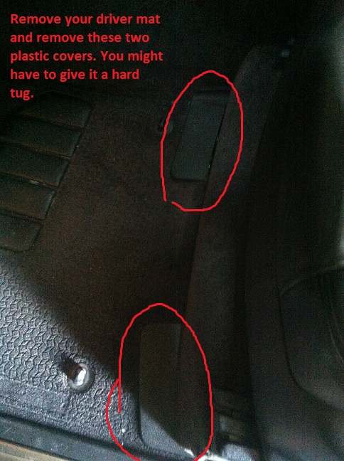

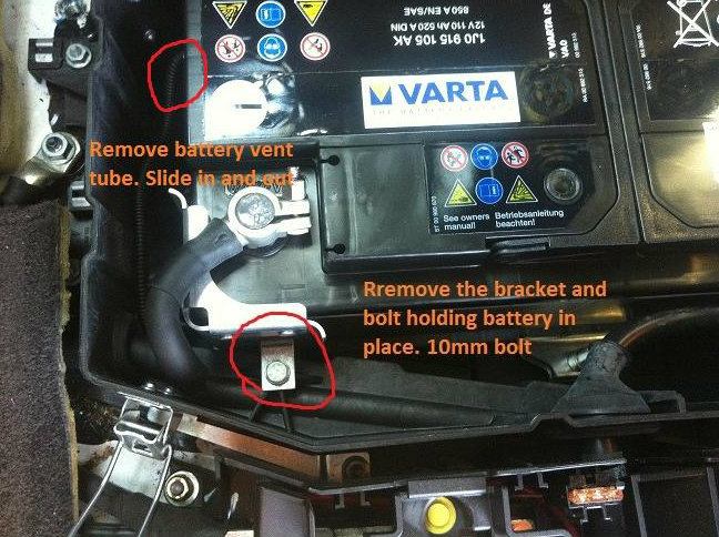

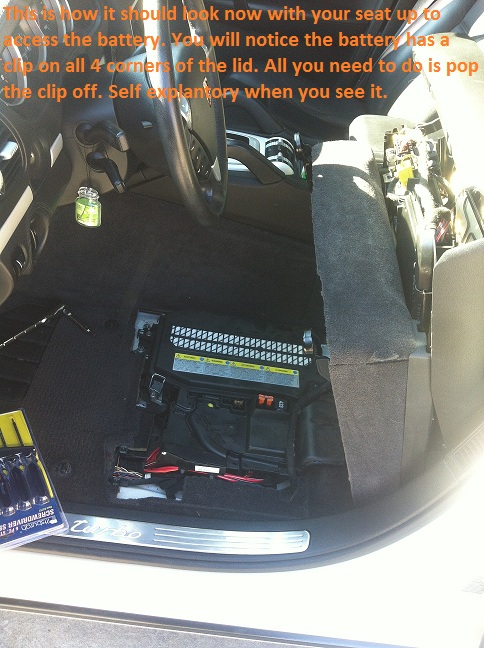

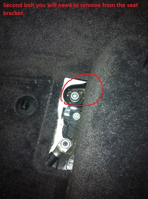

This was done on my 2005 Cayenne Turbo. I only have a battery under my drivers seat. I think some might of came equipped with a battery in the trunk.
I did't want to pay the dealer $400+ for a OE battery and labor. I was able to get mine from Advance Auto Parts for about $130 after coupon code.. It took me about 30 mins max!
http://shop.advancea...8agm&showTitle=

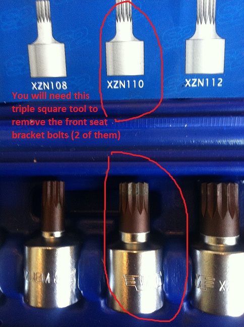

NOW PUT IN THE NEW BATTERY AND DO EVERTYHING IN REVERSE ORDER!!
Remember to put blue loctite on the seat rail bolts and manual calls for 37ft lb torque.

Forgot to mention.. put blue loctite on the bolts for the seat rails and also the manual calls for 37ft lb torque

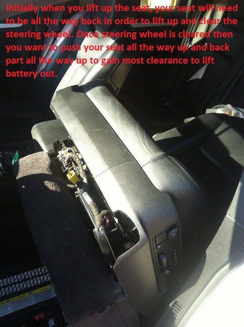

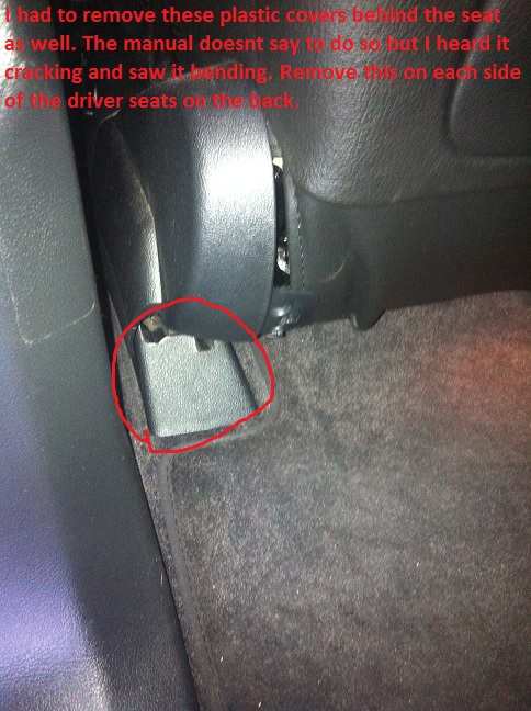

Great post! I am somewhat used to turning a wrench and actually thought that accessing the battery under the seat was unnecessarily complicated.
My biggest frustrations was:
1) You need to move the seat a few times in order to get it completely out of the way. This thread makes it easier to understand.
2) I had to remove the plastic seat rail covers in the rear since they got "pinched" (and subsequently broken) when tilting the seat back. The owners manual did not mention this and I had to buy replacement seat rail covers.
