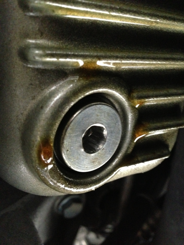

Sooo this is great news! Finally had some decent weather so I got out there and installed some parts I've been slowly ordering over the past month or so.

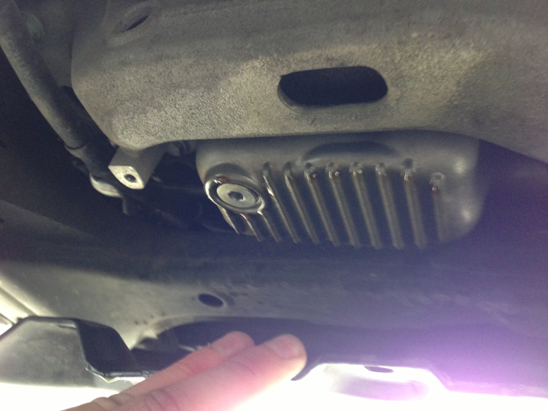

First off, took the belly pan off to find out where my oil leak was coming from, and saw a ton of oil coming from my front drain plug. Apparently the last person to do the oil change forgot to put the seal/washer back on when reinstalling the drain plug.

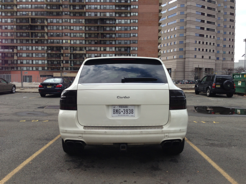

Second, finally had time to tint my side markers & install them with new LED's, install the new LED tail lights, and installed some matte dark grey trim on the lower trim panels and just under the rear hatch window.
So I bought a graphite "turbo" emblem and installed it as well, but man I'll tell you what, the dang emblem is smaller than OEM! It's probably from a 911 or something, probably an inch shorter from side to side. It looks tiny on the hatch!

So with the drain plug issue, is there a seal I need to order or do I just order a new drain plug and the seal comes with it?

The drain plugs can sometimes crack, so just to be safe I would get a new drain plug and washer. It's always a good idea to have both on hand anyways. The specified torque for the drain plug is 37 ft/lbs. For more information on the drain plugs and washers we offer Click Here.
