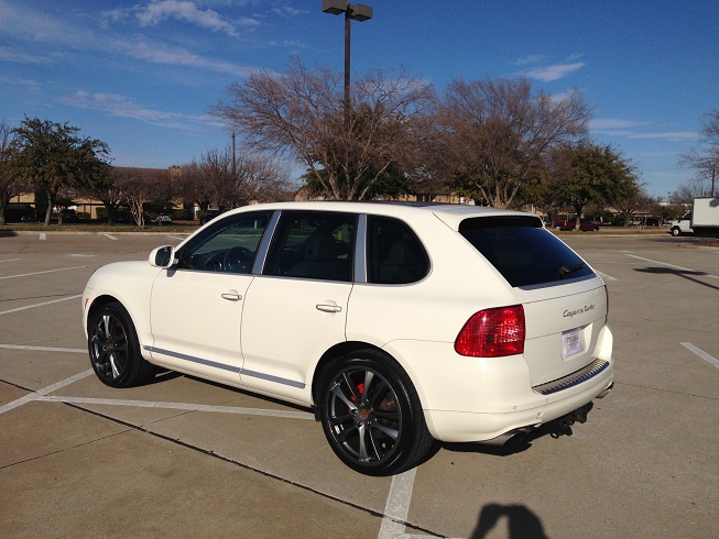

ez1973, believe it or not, they're reps. I really wanted to get something concave that would sit right on the wheel well, but after looking at these and seeing the offset calculator somewhere on here, I figured what the hay. Came with a lifetime structural warranty and 1 year finish warranty, and I know that most people would shy away from reps but for the price I figured I would give them a shot. I don't know if anybody on here is familiar with Jersey City and Manhattan roads, but I've been driving on some rough, bumpy, patched up roads the past few weeks and couldn't be happier with them. I guess only time will tell how well they hold up though, so I'll have to hope for the best with them.
They're 22x10.5 on all 4, et/60 offset
