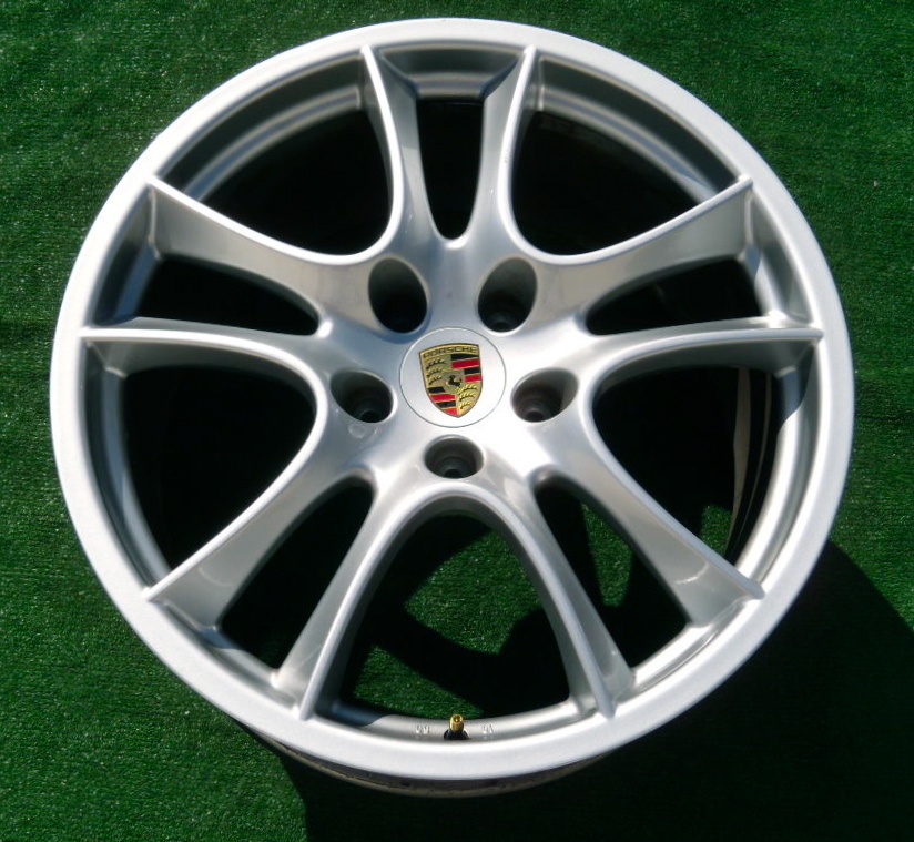

My vehicle came stock with the 21" wheels. I have 19K miles on my car and now in need of new tires again (3rd set). I am considering replacing the wheels and going with a 20" wheel and 275/40/20 tires. Does anyone have any recommendations on whether to go with the 20" x 10 all the way around or to go with the 20" x 8.5 in front and 20" x 10 on rear? I would appreciate any input.

I have the GTS wheels as well I agree, the tire choices are slim. Those wheels are actually 21x10.5 and are a perfect fit on the cayenne as well as a perfect fit for the 295-35-21.

I have the GTS wheels as well Those wheels are actually 21x10.5 and are a perfect fit on the cayenne as well as a perfect fit for the 295-35-21.

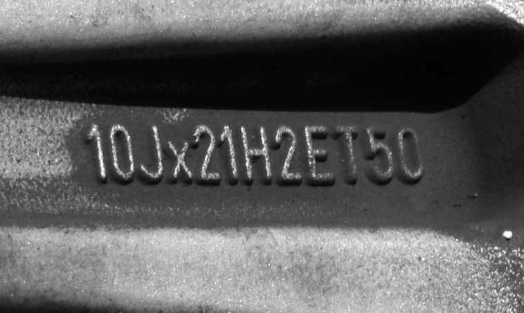

Are we talking about the same wheels? The largest and widest OEM wheels for the 957 are 21x10. Have the 21" Cayenne Sport wheels and they are definitely not 21x10.5:

Looks like you are right. OEM is 21x10 (offset 50), not 21x10.5:
