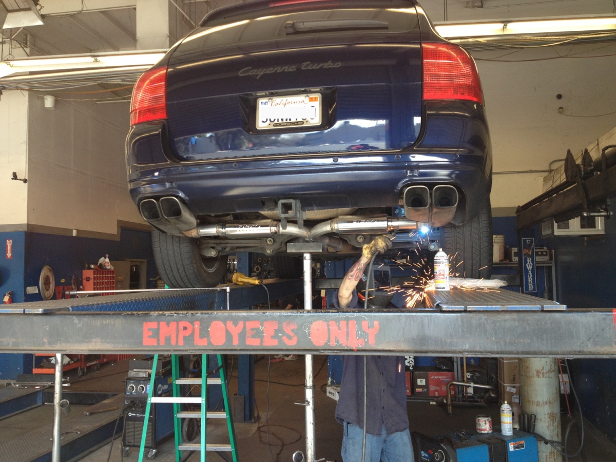

The shop built a custom H-pipe in order to delete my muffler and replace it with two resonators. I love it!

Sounds pretty nasty! Are you sure they made a H-pipe? The way the rear muffler pipes merge together, it looks more like an X-pipe..

I agree, has to be an X-pipe. Sounds great regardless...
Thank you! It looked like an x-pipe to me, but the guy behind the counter called it an h-pipe, so I stuck with it. It's an x-pipe from now on.
Yeah... I would chalk that up to a non-technical person. From what we can see, that is definitely an x-pipe. Which is good since an x-pipe will scavenge the heads better and have a slight advantage over an h-pipe.
