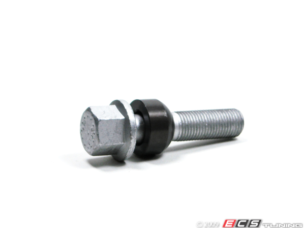

I was contemplating getting 20mm spacers for front and 25mm for rear wheels.
Can anyone tell me how long my lug nuts need to be for each of these spacer thicknesses? Have been looking around and hoping to buy the spacers but hesitant due to not knowing lengths for sure.
Also, which lug nuts are good for the CTT, any recommendations?

Stock thread length is 36mm if I remember right, so you'll want up to 56 and 61mm bolts. You can go a couple of mm shorter without problems, but if you go longer there can be issues with the bolts extending through the hubs.

Those would be the correct fitment as XR4Tim mentioned above. We offer the H&R wheel bolts that you need in the 54 MM and 60 MM size, the 60 MM are currently on limited quantity sale as we speak. For more information Click Here.
