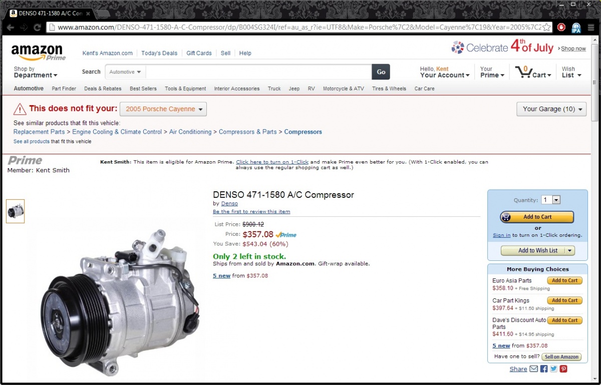

FWIW, Amazon does not seem to think that Denso 471-1580 is the right AC Compressor for an 05 Cayenne...

the 471-1580 comes in three flavors. 471-1580 RC is reman unit.
The 471-1580 NA is a new one. 471-1580 NC is oem new unit (what I got).
I called a couple different places about the denso unit I have and tried to get more info. Each (buyautoparts, discountacparts) and all confirmed fit for the 05 CTT.
As stated, the compressor fits. The only question is electrical connection.
I have found in other forums of people doing that routinely, especially when parts for makes/models get updated. Changing connector and thats it.
I will measure impedence on both units to see how they match up.
