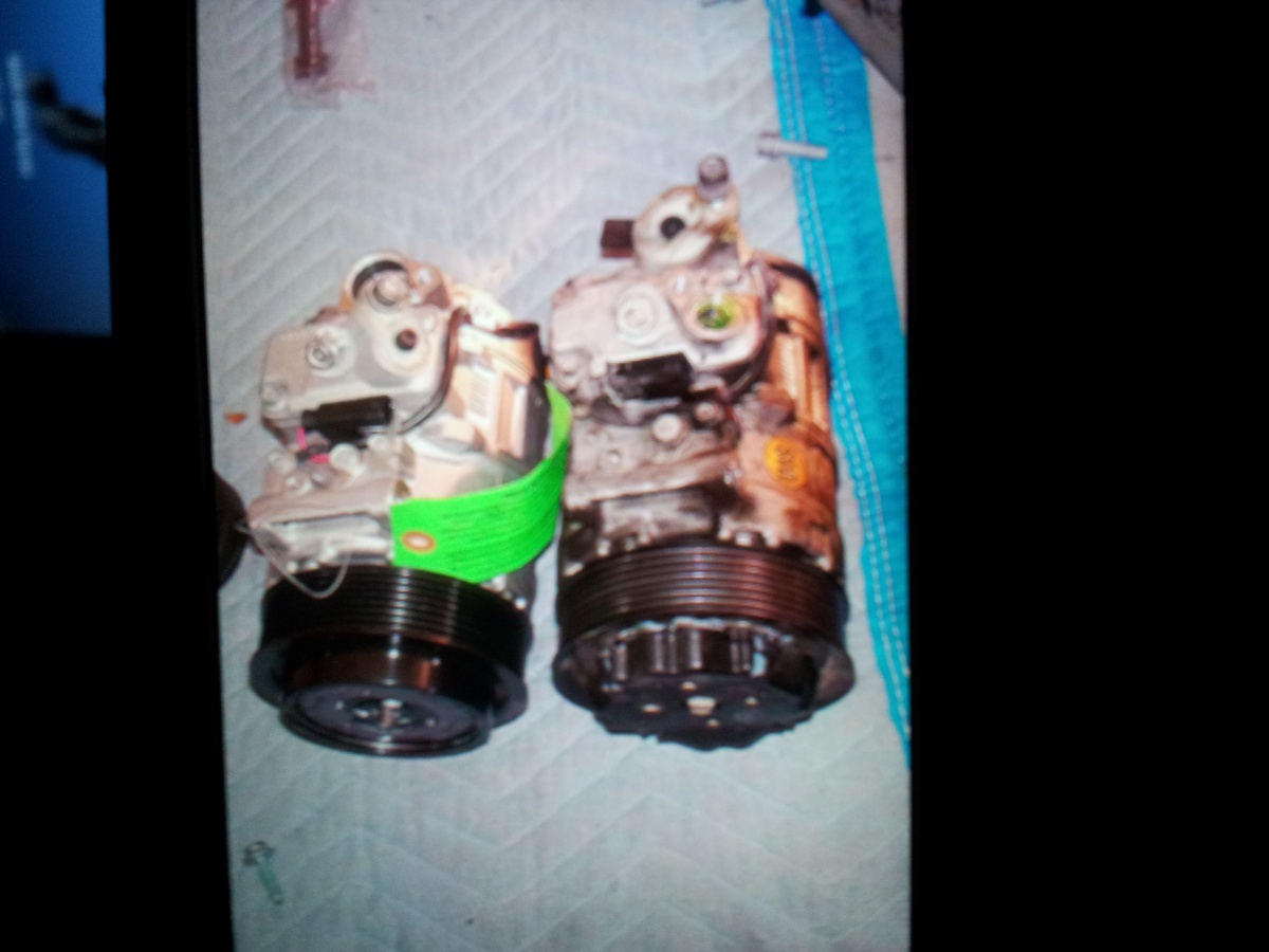

so I am doing this today. The replacement ac compressor is new denso unit for 05 CTT per sales person I was discussing this with.
AC compressor not hard to remove at all (no need to take off tire either or lining in wheel well).
However, when I got to hood up the power connector (I assume clutch engage connection), noticed that the new compressor connector has 2 wires, with black going to ac compressor chassis, and red going into the connector, whereas the old compressor connector had 2 wires run straight into the connector, where it would mate with the the connector on the car side. The new connector prong is much thinner and there seems to be a plastic edge inside the connector, preventing me from making complete contact.
SOOOOO....I am pissed.
CAN THIS BE MADE TO WORK AS LONG AS I GET GOOD CONNECTION? My thoughts are take the connector from old compressor, change onto the new ac compressor, making sure red goes into red on car side and black goes into black connector on car side (taking the black off the ac compressor chassis). Essentially changing connection to be just like the old compressor was. Is that adequate? Who has the info to answer this?
I NEED HELP HERE. car apart and I really think return/reorder is the last option I am thinking of at this time.
THANKS.

Please provide part numbers at the minimum to make sure you got the right part. Most likely not by the sound of it. Pictures would also be helpful.

FWIW, Denso's main product page does not say that is has any compressors compatible with your year/make/model. Porsche's part number is "95812601400" for a 05CTT AC compressor. What do you have?

The store part number is 60-01801 NC. Another number i see is 477280-6091. Another is 471-1580.
New. Denso oem.
Cross reffed it and appears for 2005 cayenne 4.5L engine.
AC lines fit OK. Mount holes are perfect fit.
The connector is one last thing.
My thinking is I will solder on the old connector to the new AC compressor, taking ground (black wire) from AC compressor chassis, and solder it to the connector so that car side connection with 2 wires will fit perfect to the newly soldered on connection (red to red and black to black).
Anyone has info that should stop me from doing this?
If these activate the clutch then it will work on same voltage since intended for this car. Proper voltage through car side connection, into compressor, activating clutch. Same when deactivating, voltage removed.
Need someone to chime in on theory and how it meets reality.
Thanks, will get you beer next time you're in Austin.
Old Jul 2, 2013 | 11:37 PM
ciaka's Avatar
Joined: Mar 2012
Posts: 2,298
From: TX
Rep Power: 123
ciaka has a brilliant futureciaka has a brilliant futureciaka has a brilliant futureciaka has a brilliant futureciaka has a brilliant futureciaka has a brilliant futureciaka has a brilliant futureciaka has a brilliant futureciaka has a brilliant futureciaka has a brilliant futureciaka has a brilliant future
Heres a pic

this one seems to translate to 3.2L compressor from what I see.
The people at the store confirm for the year/model/engine ac compressor.
Still, any word on replacing the connector?

confirmed with store and from online resources, get this compressor for my make/model/engine size. 05CTT 4.5L turbo.
They are identical in mold, all lines fit just fine, the only diff is the connector on new one has black line grounded at ac compressor chassis, and red line goes into conector, whereas on old one, black and red lines on compressor go into a connector. Connector on new one is slightly different (same shape). Can plug it in, but the red prong inside connector looks thinner and there is no black prong (since gounded at chassis of ac compressor).
SO my plan: remove connector from old ac compressor, fit to new compressor so that connection to car is identical.
Assuming compressor is for the car, do you see this a logical step? Researched and since this connection activates/deactivates compressor, then it should all fit fine.
Lemme know if you can. Putting things back together. That drive belt it a biach to do (putting in a new one anyway).

I just checked again and the part number given is the right Porsche part number for a 05 CTT. It has been superceded a few times. The original part number was 94812601101. It then was replaced by 95512601101. And then the latest Porsche part number is 95812601400
