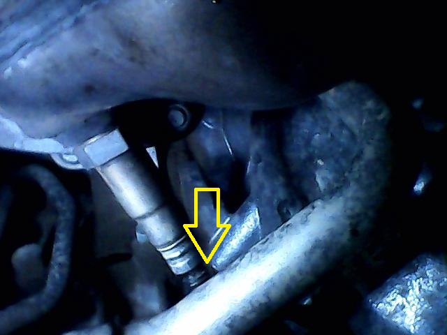

So it turned out that changing the MAF sensors did not solve the surging problem, so it was on to the O2 sensors (and then the fuel pumps if that failed).
Porsche Center Johannesburg quoted 6 hours labour for the job and after reading some other accounts of the task on this and other forums, I was prepared for the worst.
I purchased 2 oxygen sensor tools on ebay in preparation.
Turns out the job on my 04 Cayenne S is not really that difficult, its awkward, but quite doable, (I 'm an aeronautical engineer not a professional mechanic so I consider my spanner swinging skills mid level).
The repair manual I used said to remove the wheel and wheel housing liner, but I found this unnecessary as the entire job can be done from above ,just removing engine covers and the airboxes.
With these removed you can actually reach the oxygen sensors with your hands. The problem is you cannot actually see them. I used a USB endoscope to get a view of what I was doing. The attached pic of the sensor was taken using the scope.
I've attached pictures of the oxygen sensor tools and a picture of the right side sensor. The problem is pointed out by the yellow arrow. The wiring exiting the sensor bends sharply immediately after the sensor as the sensor is very close to the engine block, this means there is not enough space to thread the tool over the sensor, so the nice chrome tool was totally useless for the job. I managed to thread the black tool along the wire of the left sensor and remove it. On the right sensor I resorted to cutting a standard 22mm spanner short (about 150mm) to make a "special tool". That worked perfectly.
So long story short, the job took about 2 hours and best of all the surging is now gone !!
