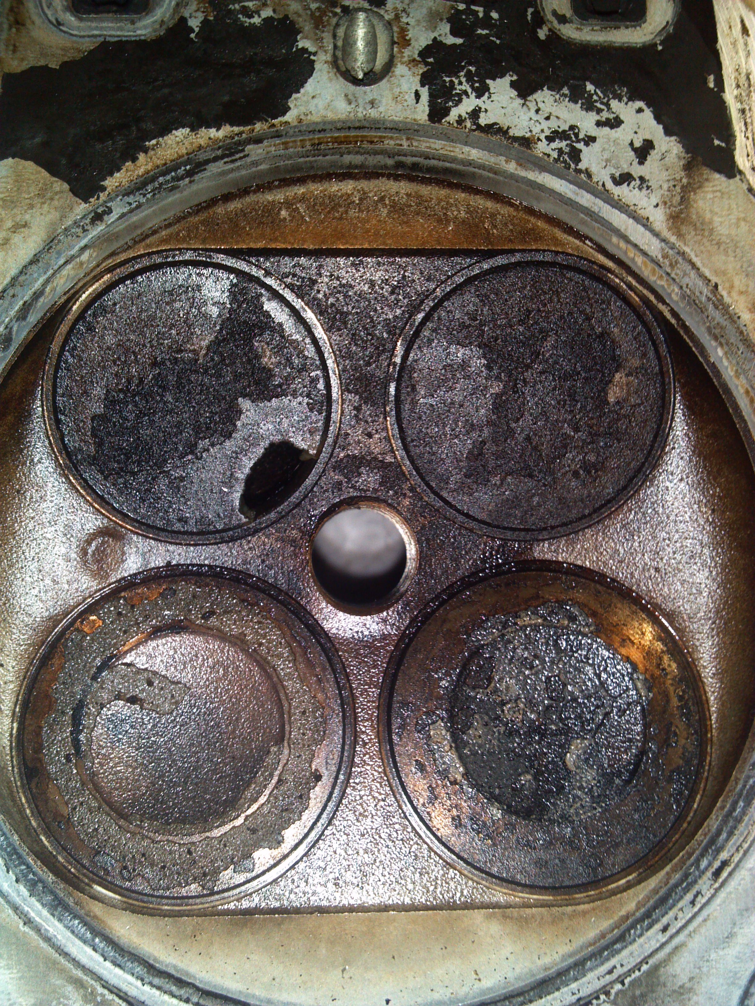

Looks like I found the problem! All the cylinders look amazing and absolutely zero evidence of the valve striking the piston. The edge of the break in the valve head is all crusty too like it may have been cracked for some time before it broke off. I didnt find the piece in the primary cat and from an outer inspection the turbine wheel seems to be intact.
I purchased the vehicle as a one-owner with 65k on the clock. I now have 170k. Upon dissasembly I noticed that the timing chain guides and oil pump chain guides are all in amazing condition as well, barely worn. There is also blue sealant on the chain cover that I did not find anywhere else. Makes you say hmmmmm...

no pieces found make me think its been burned but, though hard to tell in the pic, it does look like it failed from a crack.

Originally Posted by Mr. Haney
....I purchased the vehicle as a one-owner with 65k on the clock. I now have 170k. Upon dissasembly I noticed that the timing chain guides and oil pump chain guides are all in amazing condition as well, barely worn. There is also blue sealant on the chain cover that I did not find anywhere else. Makes you say hmmmmm...
What brand and type of oil have you been using since ownership to have your internals in such a fine state?

I use Shell Rotella t6 5-40 sunthetic. I do not really know that the internals are in fine shape. I just thought that the cylinders looked great and the chain guides didn't seem to have 170k miles in wear, that they looked great for the 100k abusive miles I have put in!

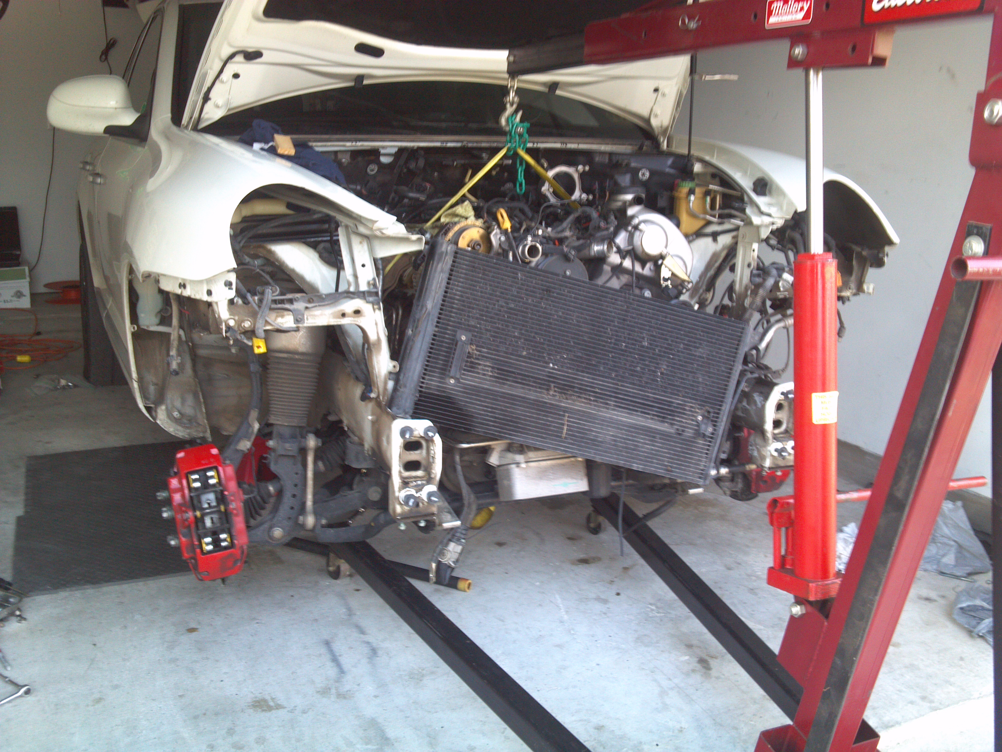

Engine is out of the Cayenne and I can answer any questions that any of you may have about that or things that you may not have access to or be able to see while it is in there.
I have thought about replacing my turbochargers for added performance, but was going to drop the subframe. I think book says 38 hours labor. I have only seen one other person go from the front and remove the front carrier to remove the engine with a standard engine hoist.
  • How many hours did it take to remove?
  • Did you remove the engine with the transmission?
  • Can you please post any pics that may have been taken?

I would guess that working slowly over a couple days( it was the holidays!) it took me 12 hours to get the engine out. Im sorry, I did not take any pics at the time but everything is apart now so no prob. Any kind of writeup just was not in the cards on this one.
What I did was take the entire front end of the car off. The bumper, bumper support, radiator support, radiator/coolers/fans. I intended to just take the engine out, but its really a simple design and meant for the whole assembly to come out together. It was really easy for the most part. There really are a minimum of connections to drop the engine, subframe, tranny, transfer case, front air shocks and suspension all as one unit so that is what I did. Other than being insanely heavy it was easy. I just used some lifting straps kind of like seat belt material and wrapped them around the subframe and dropped it all down and then pulled out the front. I have a height consideration to deal with as I am doing this in a two car garage. Anybody that does not have a four post lift will have to do it this way as you will not have clearance to get the vehicle high enough to slide the assembly out past the front bumper/ rad supp. As a side note, when it came time to set it all down it was very cumbersome and tricky. Like I said that whole assembly is insanely heavy and my two ton hoist was struggling on the 1 ton setting. I think if your just doing turbos then just hook up the hoist, drop it straight down for access, do your work, and lift it straight up back into position. I,ve seen your work Renn man and I don't think you would have a problem.
The tuner that does the 700hp conversion and I had a frank conversation as I made it clear I was not interested in soliciting his services, just having some shop talk and he was extremely nice. He told me that they got their cayenne new, did the upgrade and then raped it for 160k miles before selling and the Cayenne held up well at that level with no issues. So, that is nice to know. Porsche really put a lot of work into the Cayenne and the engine is a work of art and way overbuilt in my opinion. This is an incredible vehicle.
Is this a DIY at home? I guess so But definitly extreme and Im sure much much easier in a shop.
