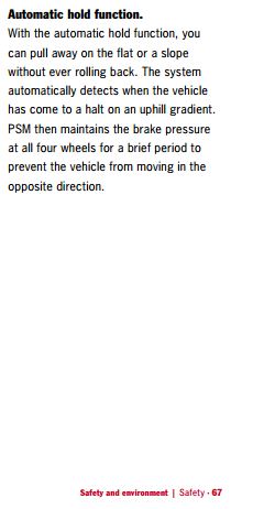

...thanks for the info above, and here is info I found straight from the Porsche brochure about the hill hold feature: see the pic (captured to show)...
....and that'll be for a manual tranny.
Here you go, straight from the Service Information Tecknik publication.
Porsche Drive-Off Assistant (PDOA) Cayenne, Cayenne S Drive-off Assistant on vehicles with manual gearbox.
If the vehicle is fitted with a manual gearbox (only Cayenne and Cayenne S), the Porsche Drive-Off Assistant supports the moving off process uphill. This applies whether driving off forwards or in reverse.
The following preconditions must be met:
• The vehicle must first be parked with the brakes (service or parking brakes). If the vehicle only freewheels to a halt, the PDOA is not activated, i.e. the vehicle is not prevented from rolling back as on the Hillholder (only on Tip- tronic).
• The clutch must be operated and a gear engaged. If the gear is disengaged and the clutch released, the brake pressure is released and the vehicle rolls independently.
• The engine must be running.
• The vehicle must be on a definite incline.
If all these preconditions are detected by the control unit, brake pressure is built up at the front and rear wheels through the “active brake servo”.
On driving off, the braking torque is again reduced in relation to the driving torque present.
