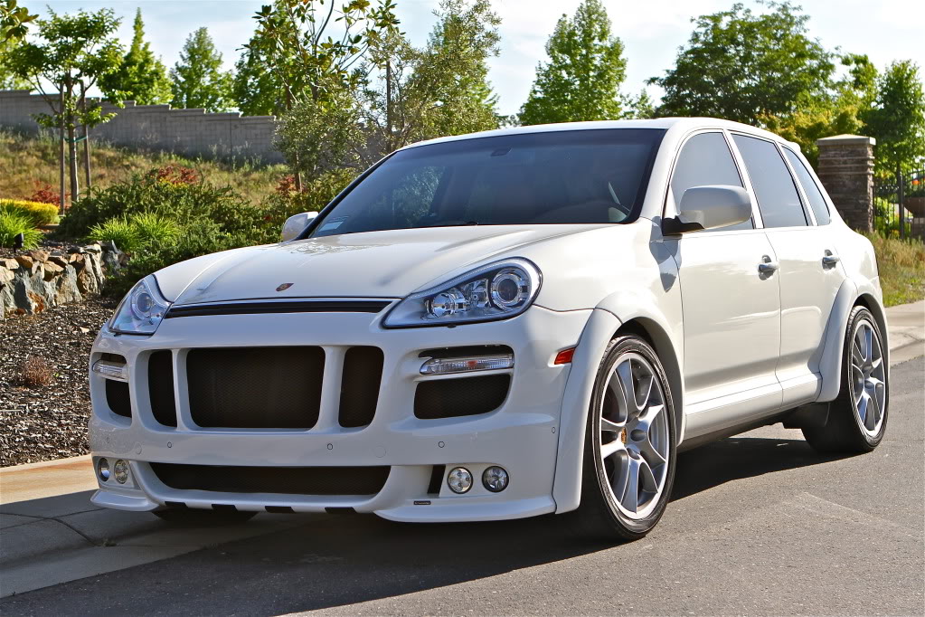

Here is a picture of my Hamann Body kit on a 2008 CTT.
Not bad, but I have seen body kits that flow better with the rest of the car. How about this one offered on Ebay?
http://www.ebay.com/itm/Porsche-Caye...torefresh=true
I'm not a big fan of 4 fog lights. If I can get all of the 4 fog lights out and use 2013-2014 Cayenne Turbo LED daytime lights and turn signals with this body kit, it would be awesome.
Has anybody tried using the 2013-2014 Cayenne Turbo LED daytime lights and turn signals on 957 Cayenne Turbo? I think the new LEDs function as both daytime lights and turn signals.

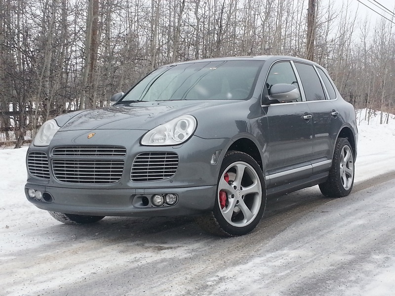

That kits looks a little like the Techart setup, which i have on mine, i like the 4 fog light thing, but i never use them.
I know it's possible to retrofit led DRL's, Philips do a good plug and play set, which i would like to fit to mine but the previous owner had the headlights wired so that they are permanently on, i can't physically switch them off.
Mines a 06 CTT with e81 powerpack and a few mods in the region of 600HP
