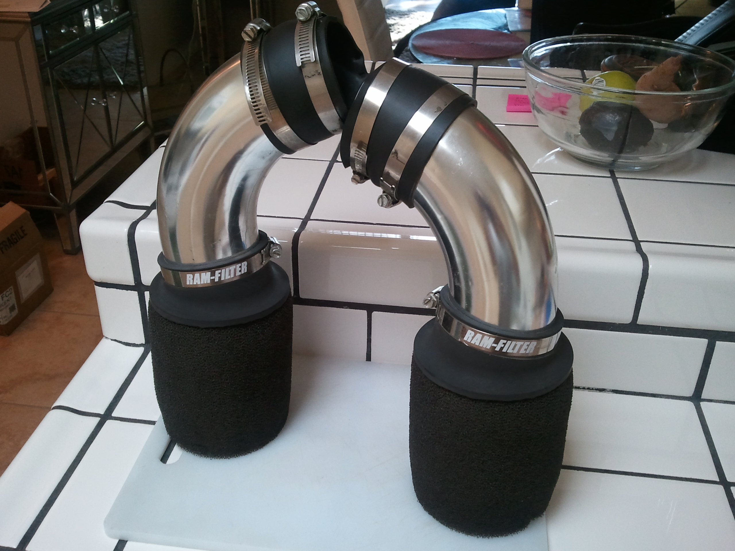

You're paying a lot of $$$$ for throatier sound... which is really nothing but a loud snort of air. I just sold my Ram Filter CAI(paid $200/sold for $150), because I got tired of always uninstalling it just to pass smog. My improvised, cold air isolaters were two cut-up trash bins, attaching the original metal shield to them. In the end, pleated paper filters are still the best... as long as they remain clean.
