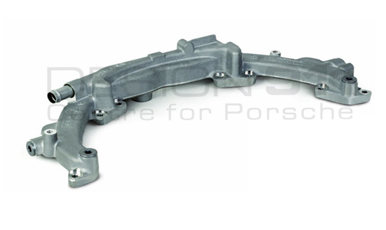

This is the part in question that is failing:
http://www.design911.co.uk/uploads/i...4810606104.jpg
To be more specific, it is the hose barb to the left of the number 3 on this image that is slipping out and causing massive coolant leaks:
This what is looks like when the epoxy fails and the barb becomes unglued from the rest of the water distributor housing:

Unfortunately, the official Porsche repair calls for dropping the engine! This is mainly due to the placement of where this part is - squeezed behind the back of the engine and the firewall.
If we take a look at how the 911 guys are resolving this, many of them are drilling a small hole in the barb and main casting, tapping it, and inserting a set screw to mechanically bond both pieces; thus stopping the barb from backing out and avoiding a catastrophic coolant failure:
Another enterprising individual, actually welded his barb to the main casting:
Any of these solutions are much better than just buying a factory replacement coolant distributor since it looks like they have not changed the design to remove the two piece epoxy solution.

In a perfect world, I was going to either:
A) remove my barb, thread the hole, and insert a threaded barb fitting with epoxy or thread sealant.
B) weld the barb and the casting together
C) remove the barb, rough up the inside of the casting, clean with acetone, JB weld (epoxy), and use a set screw
In the end, I think all of these solutions are slightly over engineered (not a bad thing). Just not sure if it is worth the pain of completely removing the water distributor, modifying, and reinstalling in such a tight area.
I am now leaning towards taking advantage of the fact that my transmission is out and just drilling, tapping, and installing a set screw (like the 911 guys) while the water distributor is still installed on the engine.
This is the easiest solution and should prove adequate in the long run.

Just completed drilling and tapping my hose fitting with a set screw. I used a automatic center punch, M4-0.70 stainless steel socket cap screw (8mm length), a #30 drill bit and a M4-0.70 tap.
Here are the pics:
This is the area that I will be working in (transmission fully removed).. you can fully see the water distributor from the back:
Here is a close up showing the problematic barb that may come out with time (circled in red):
This is where I will be drilling a hole to install the set screw (red dot):
I used a centering punch so the drill bit will not walk:
Hole drilled. In hindsight, I wish I fully drained all of the coolant first. About a gallon came out:
This is my M4 thread tap and adapter. I will be using a hand tool to create the tapped threads since space is limited and the aluminum is soft to cut:
I used JB Weld (Marine) on the screw threads to permanently bond the inside fitting and the outside casting of the water distributor together:
This is the finished results; a permanent solution. Now I will pressure test the coolant system (after epoxy cures) to make sure this hole will not weep
Note: I abandoned an attempt to smooth out the casting around the hole after realizing that it wasn't worth the effort:

One more failure to add to the list;
Cayenne S 2008
Pipe blew right out during a downshift, causing sudden coolant loss.
I've been told there is a newly designed water distributor with Part Number 94810606107. Apparently this time the outlet is threaded into the water distributor housing instead of just bonded in place. The way it should have been done initially.
Of course it seems the only way to get that part installed safely is by dropping the engine...
Thank you to the bean counters who decided to save $1 in this area despite knowing that it would compromise safety, brand integrity and customer satisfaction.
Has anyone had any luck yet tapping the thread from the top of the engine?

For reference
