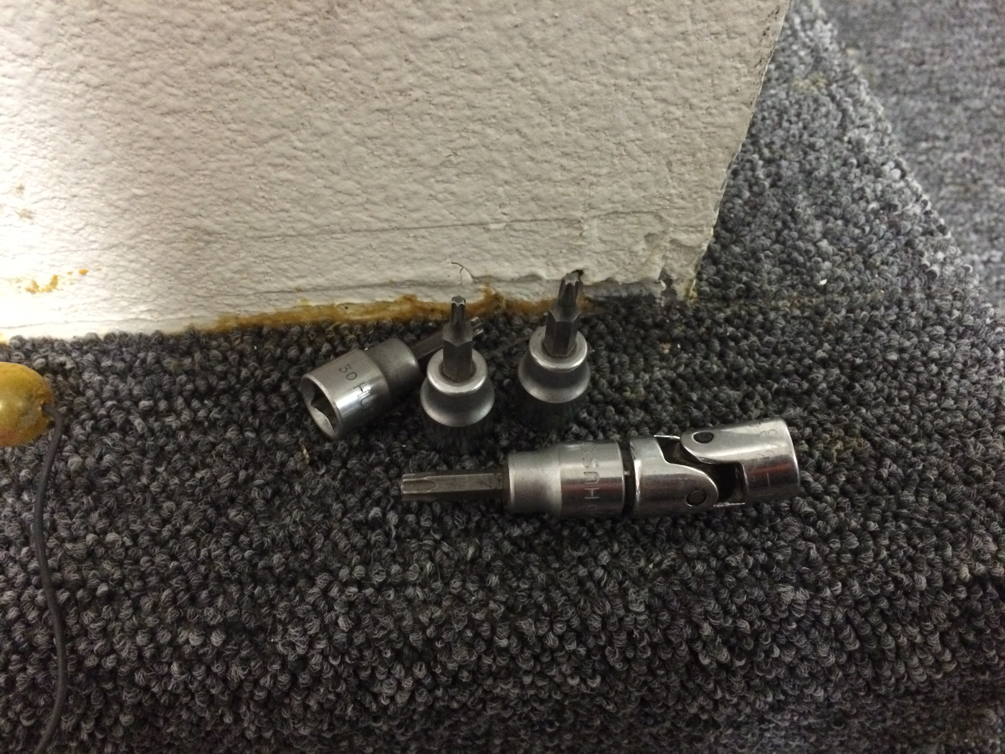

Tools
Here are some basic tools you need to take apart

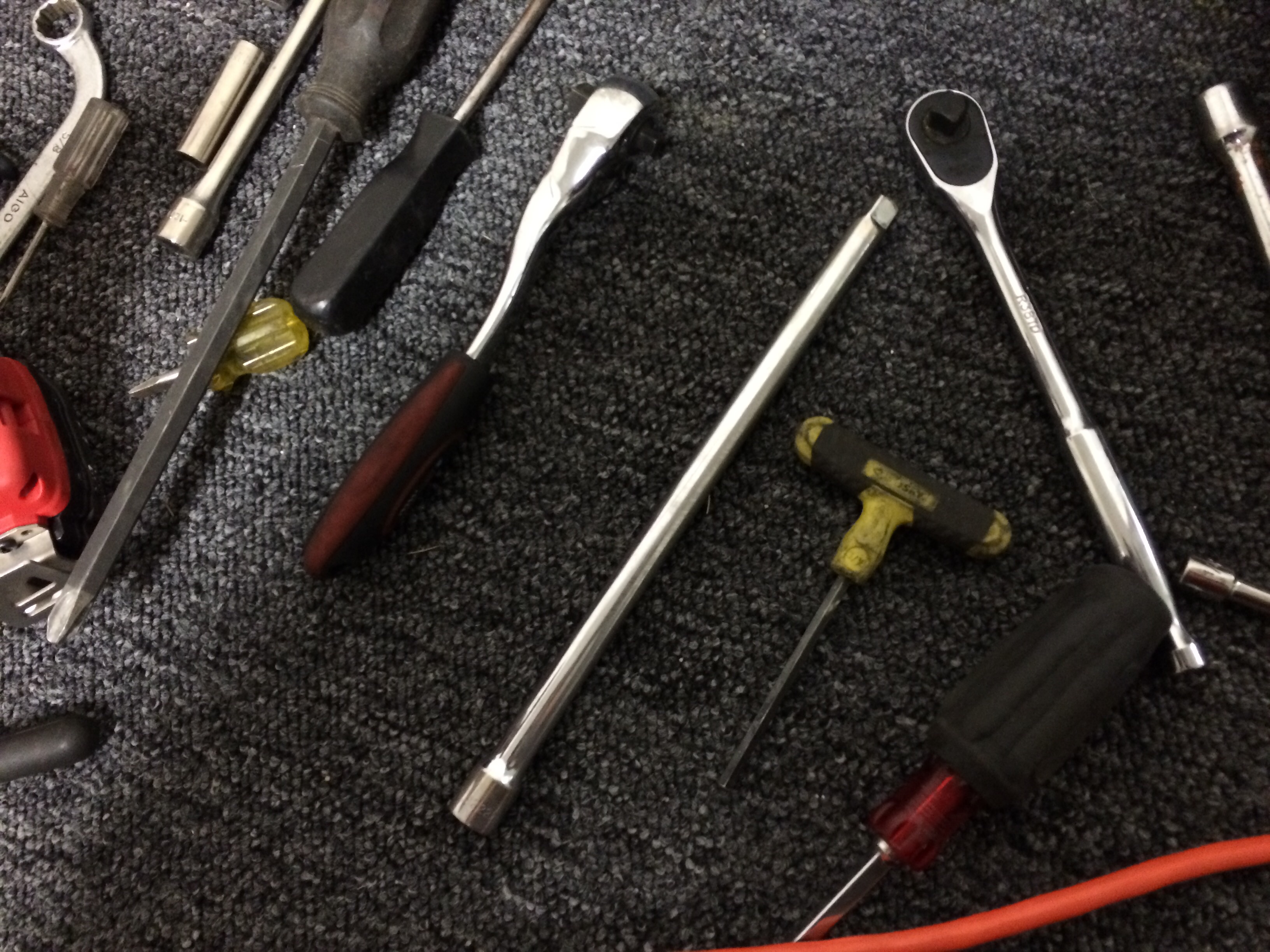

Few more. The hose clamp tool ecs sells would be probably nice to have. I just used needle nose pliers. They also sell a coolant pressure test kit which I need to by or you can rent / buy one from auto zone for two or three hundred then return. That's about it and maybe a Drexel tool to remove old pipes
