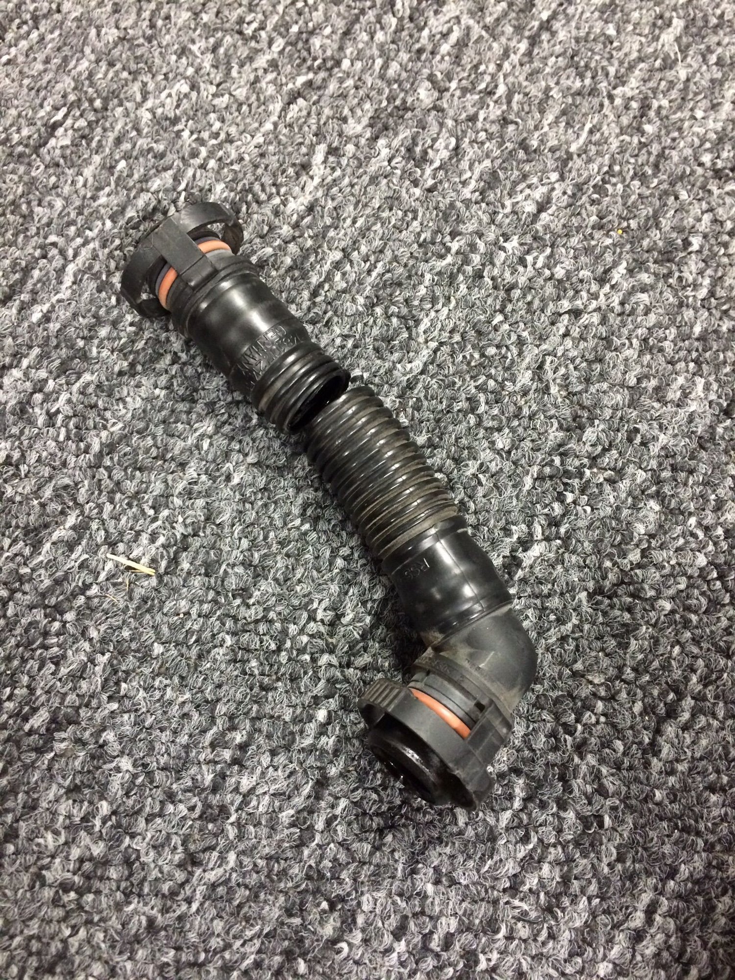

Ok cool sounds good. Mr. Haney also has a file on how to do everything also he emailed me. Incase you want more details. I'm just about done just removing old pipes and ordering kit.
Broke this though so need to find another one. Going to search the part #
