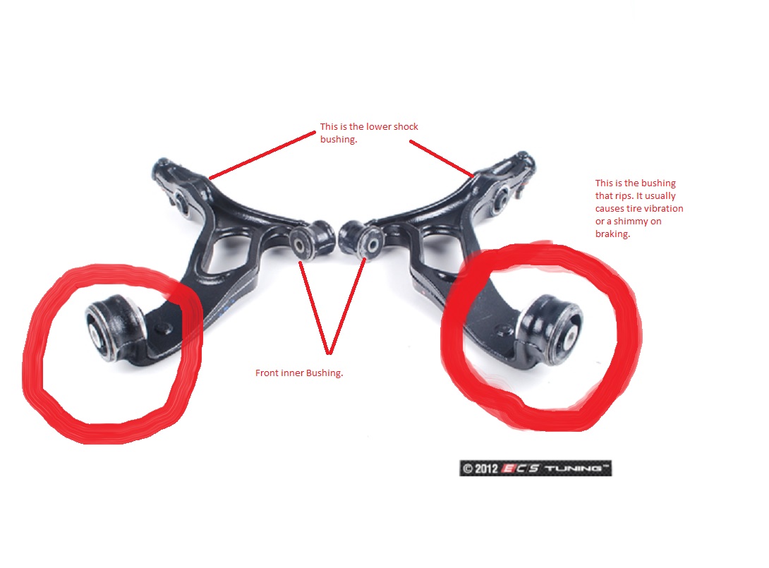

This is the lower bushing that is different on the Turbo S.
Your upper arms may be worn as well. The tend to do this. Name:  339982_x800.jpg

That's awesome info. Thanks a bunch mr Haney.
