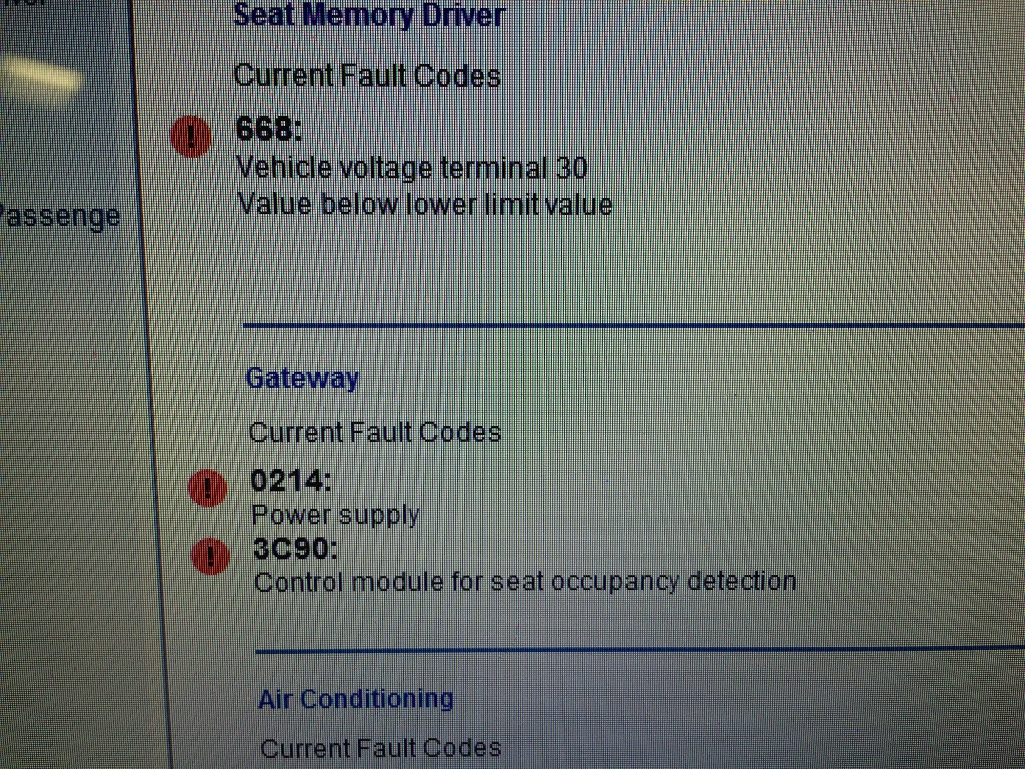

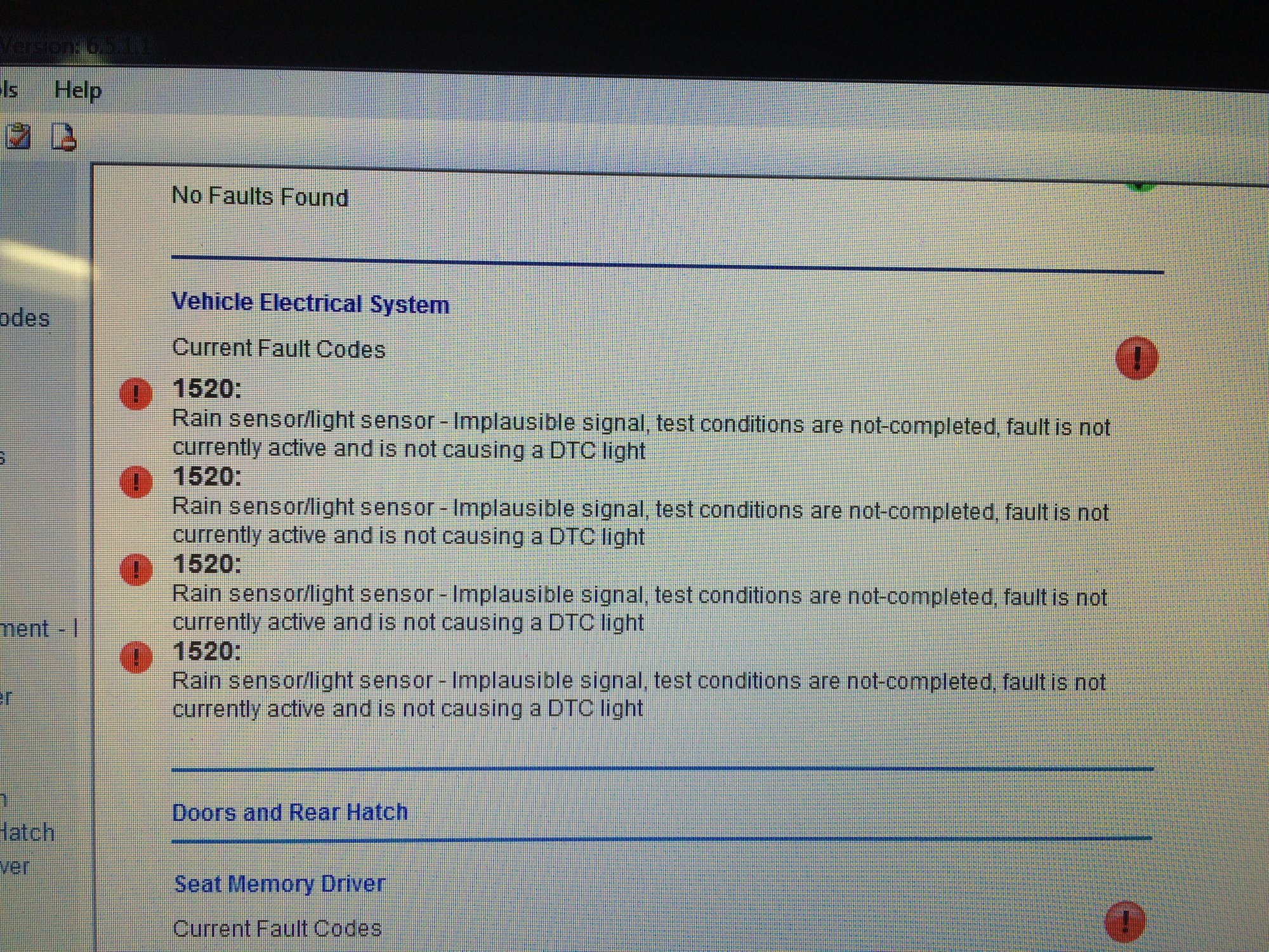

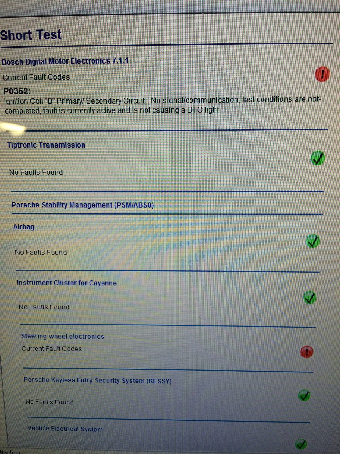

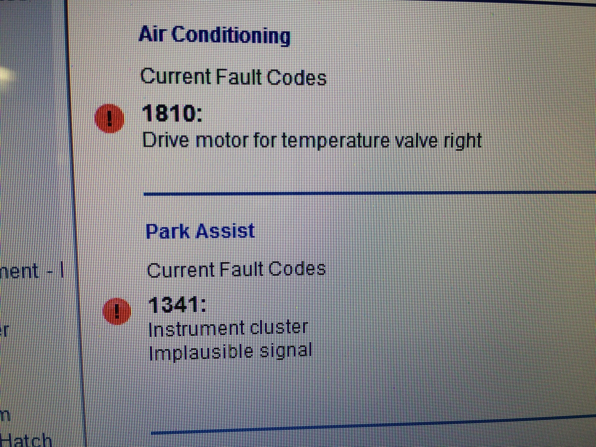

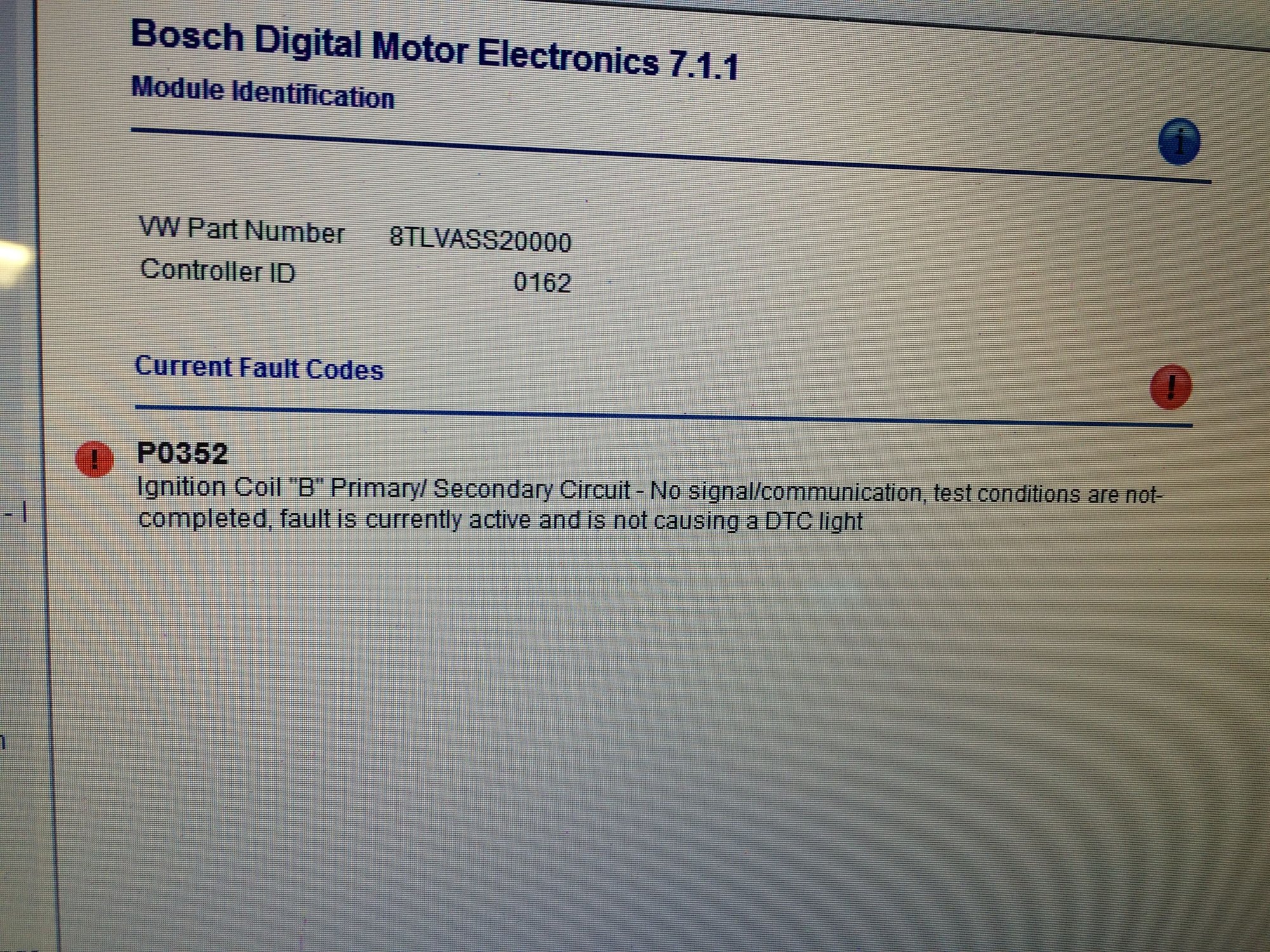

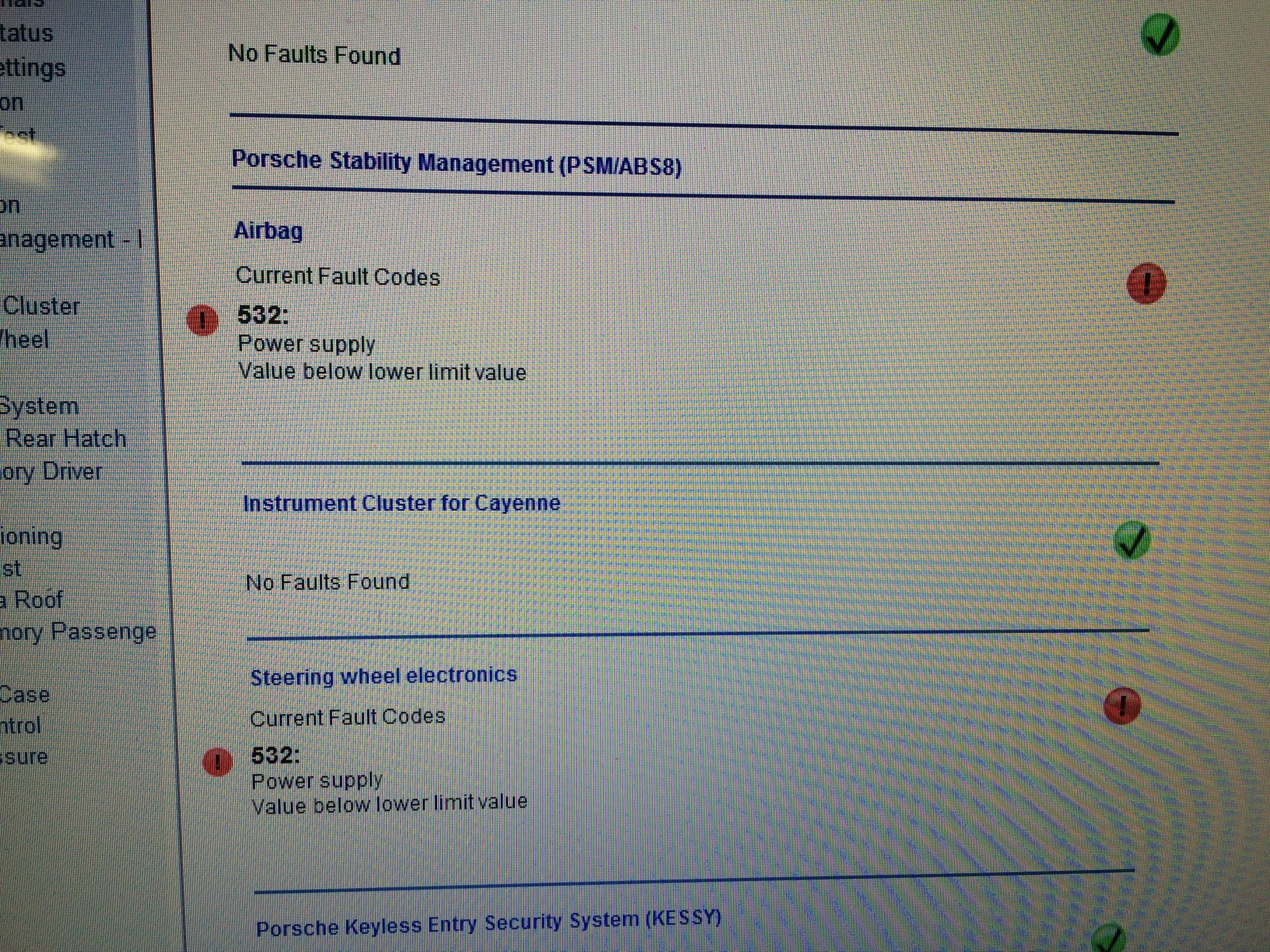

Well changed coolant pipes now have all these codes. I also put in a new battery from Napa and he gave me a H7 do you think this could be a cause for allot of the errors? I'm thinking he gave me the wrong battery. I think it's supposed to be a h9?. Car also has been sitting for six months. Cleared codes but all come back. Still rough idle and loss of power. Can you also show me where cylinder two is located or cylinder order pics

Any help would be appreciated. Just got my durametric tonight and learning and researching. I guess I need to check all the coils are plugged in right I guess

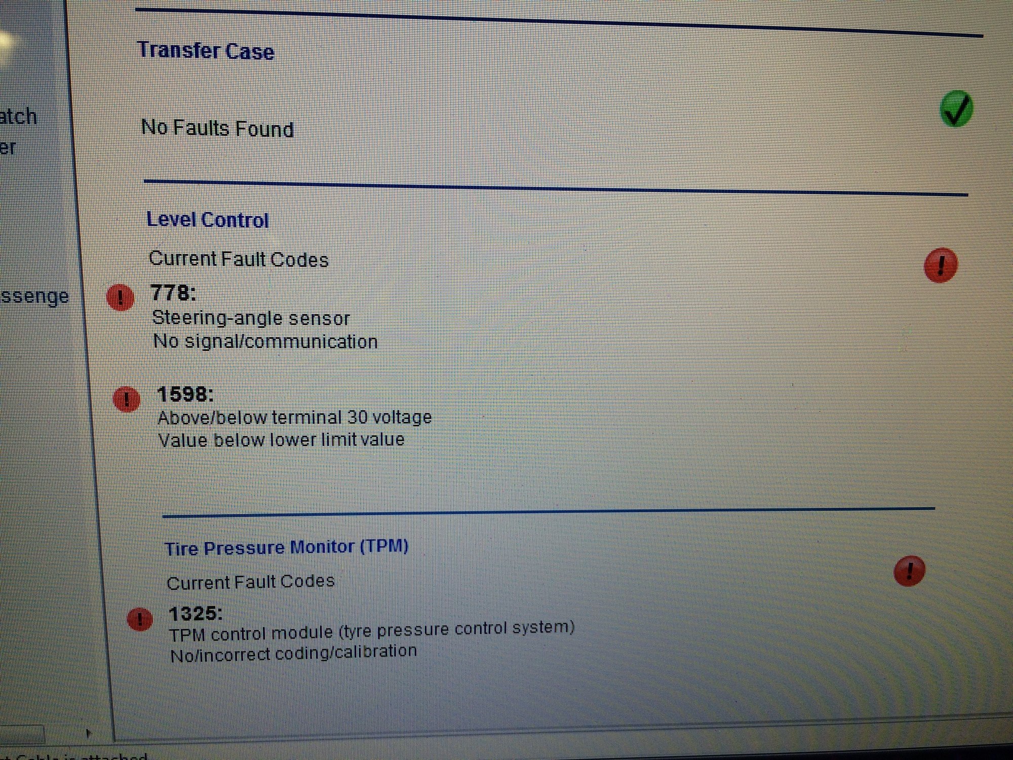

Your replacement battery should be rated 850-1000 CCA, anything less than that may cause the control modules to throw fault codes.
Thanks for response. On my way right now to exchange it to the correct batterie I hope. Even the one I search on Napa is different then the h7 he gave me which I believe is for the cayenne s.

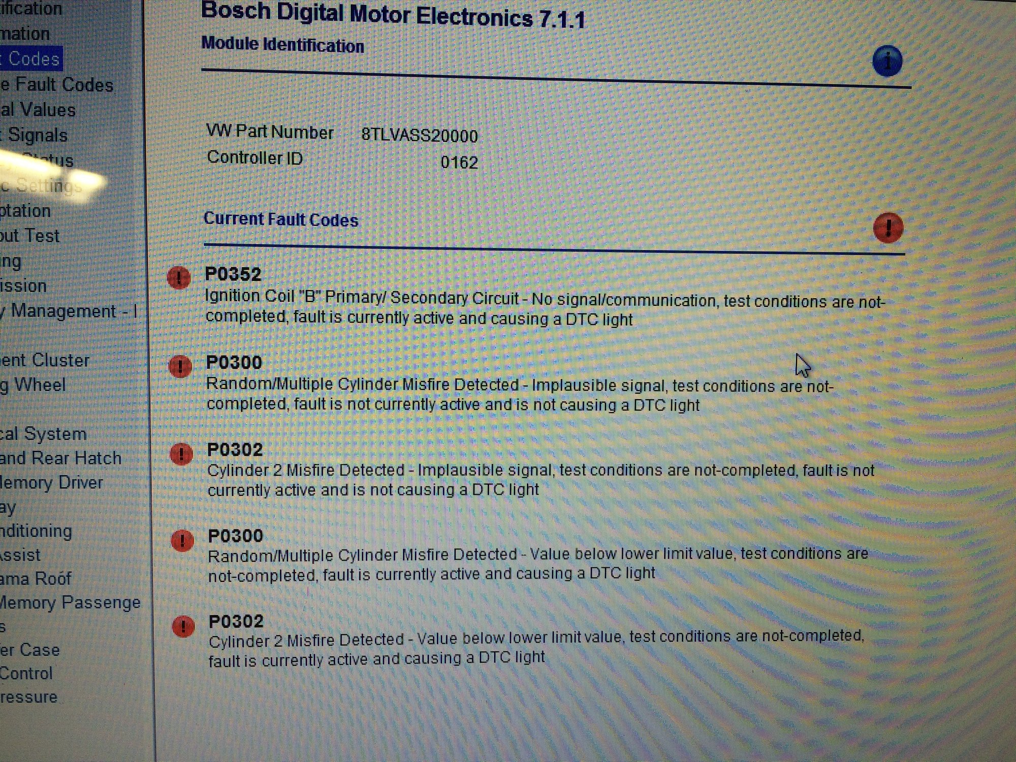

Well put the correct battery in and cleared codes. Still have these though

This fault code would be accompanied by misfiring if the coil is actually faulty. I would check for loose connectors on the coil circuit for No.2 cylinder

Hey thanks for the help with the connector also. I thought I would never find it. Your a stress saver ��
