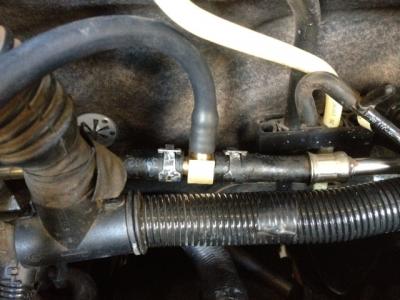

Does anyone know what this is for or if it's supposed to be hooked up? Took my intake off not sure if I broke it or not but looks like it's been that way for awhile not sure. Thanks for any help I have the 955 ctts
Not sure what the little white breather valve thing is there

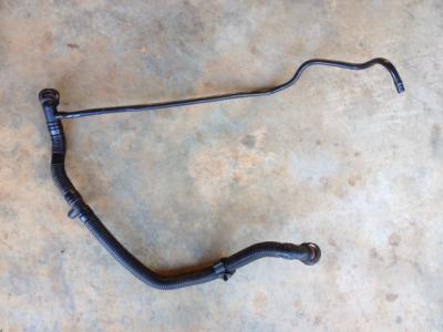

That is where a vacuum or breather hose connects to. Here is a pic of the complete hose and how to fix it. It runs under the passenger side plastic cover and hooks up to the fatter hose which goes across near the front of the engine. You should be able to see what is missing The original nylon T gets brittle and breaks easily. I replaced mine with a brass T. To get the nylon out I had to break it up with a pair of pliers and suck the bits out with a piece of tubing stuck into the crevice tool of a vacuum.

That one is not included in the coolant pipe kit. Here's a better photo of the hose, where you can see the white tee connection:
The part number for Turbo applications is 94810721552.
