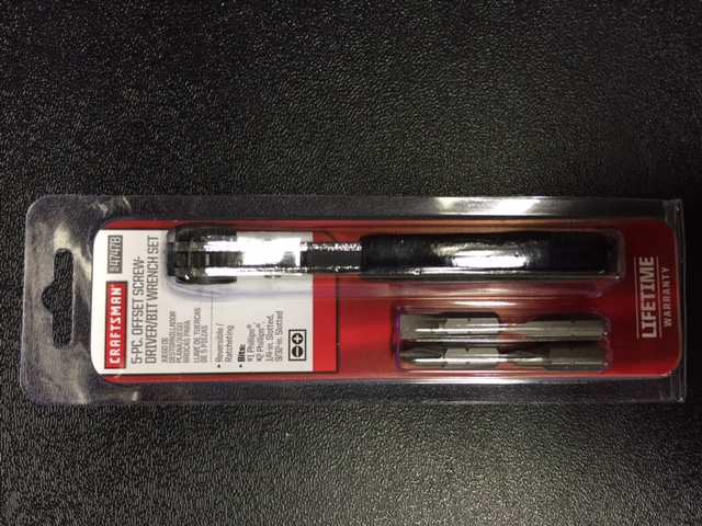

I think 958 side marker can be poped out but not on 957. 957 somehow also different than 955 that has two bolts and the top bolt is the one I am having difficulty to reach with oridinery tools. Someone recommend to use flexible screwdriver or ratchet. I have ordered one of these and will give it a try this weekend.

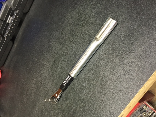

So I couldn't wait until this weekend to replace the side markers so I did it this evening and I like to share the result/experience.
Tools required:
Torx T20 - For wheel liner bolts
Torx T27 - For side marker bolts
Mini ratchet screwdriver - For side marker top bolt removal
For the passenger side, it is a bit painful that I actually removed the headlight assembly to give me additional access & support to help remove the side marker top bolt as there is a hose next to it (refer to attached photo) if access from wheel liner. In order for me to remove the top bolt from the headlight area, I had to make my own extension (refer to other photo) and it took me about 20~ mins to replace it.
Driver side is a easy one that there is enough room/clearance to unscrew the top bolt so no need to move the headlight assembly. It only took me about 5 mins to replace.
