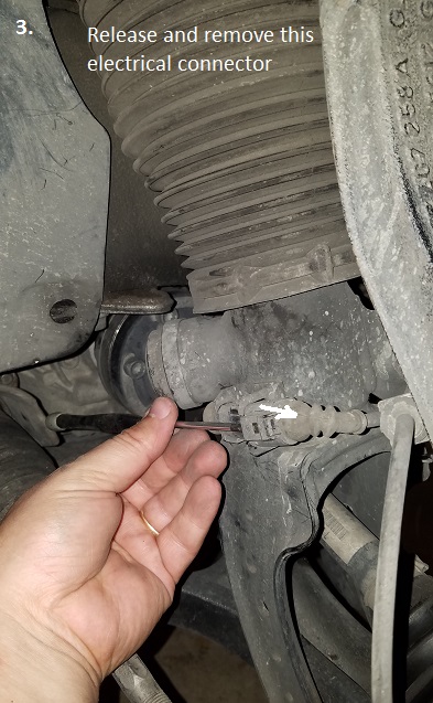

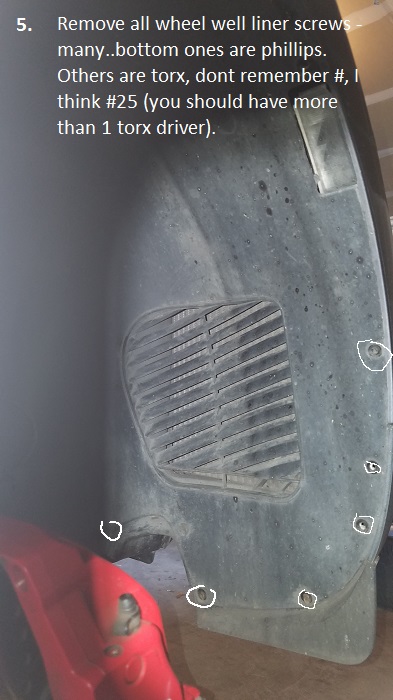

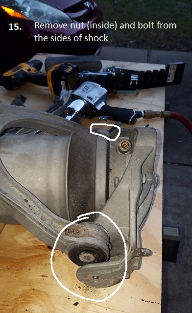

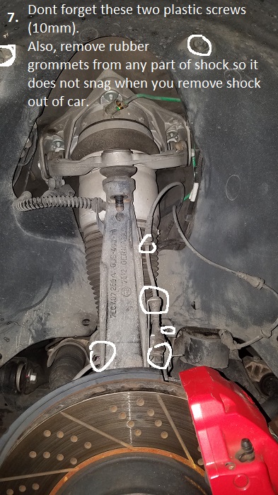

If you notice your car is squeaking a lot at front, not smooth over bumps, has noises coming out of front, chances are your shock mount bushings are damaged and need replacement.
If you need to do this, I hope you can use this tutorial to get it all fixed. Hope it helps. Feel free to give feedback afterwards. Thank you.
Pics labeled *-DRV are for driver side shock...otherwise everything else is same on both sides. It is Pics 18 and 19.
