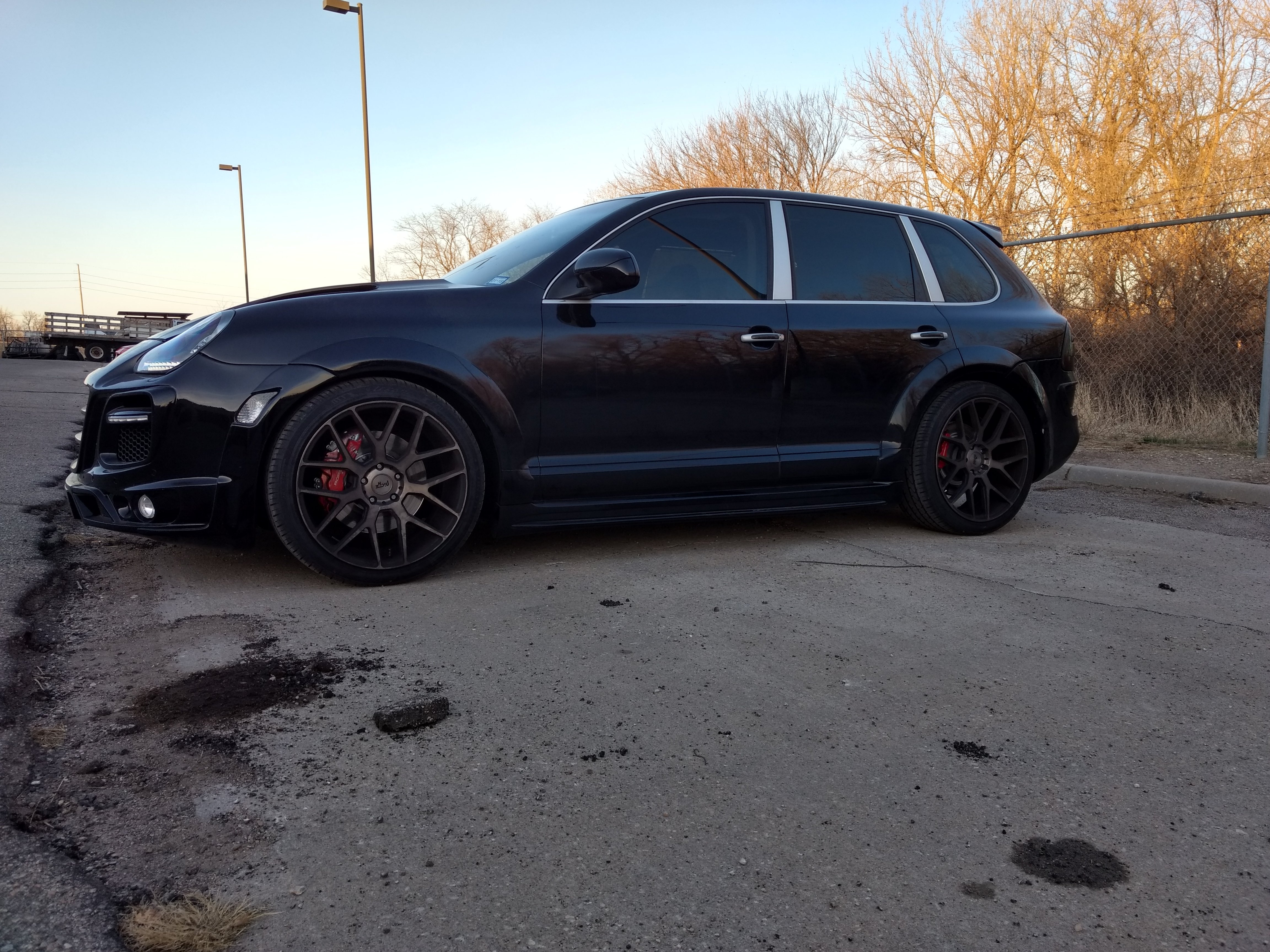

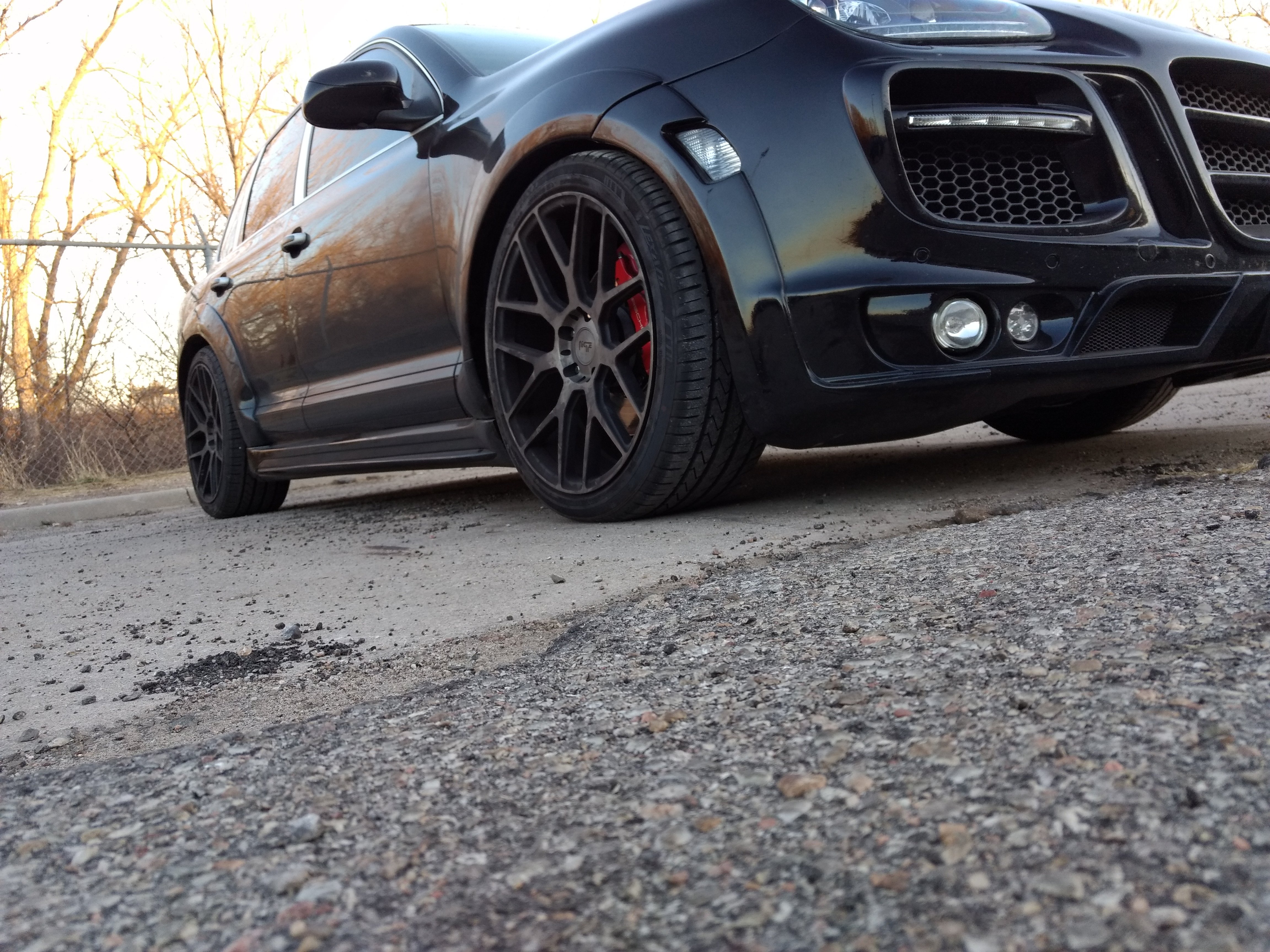

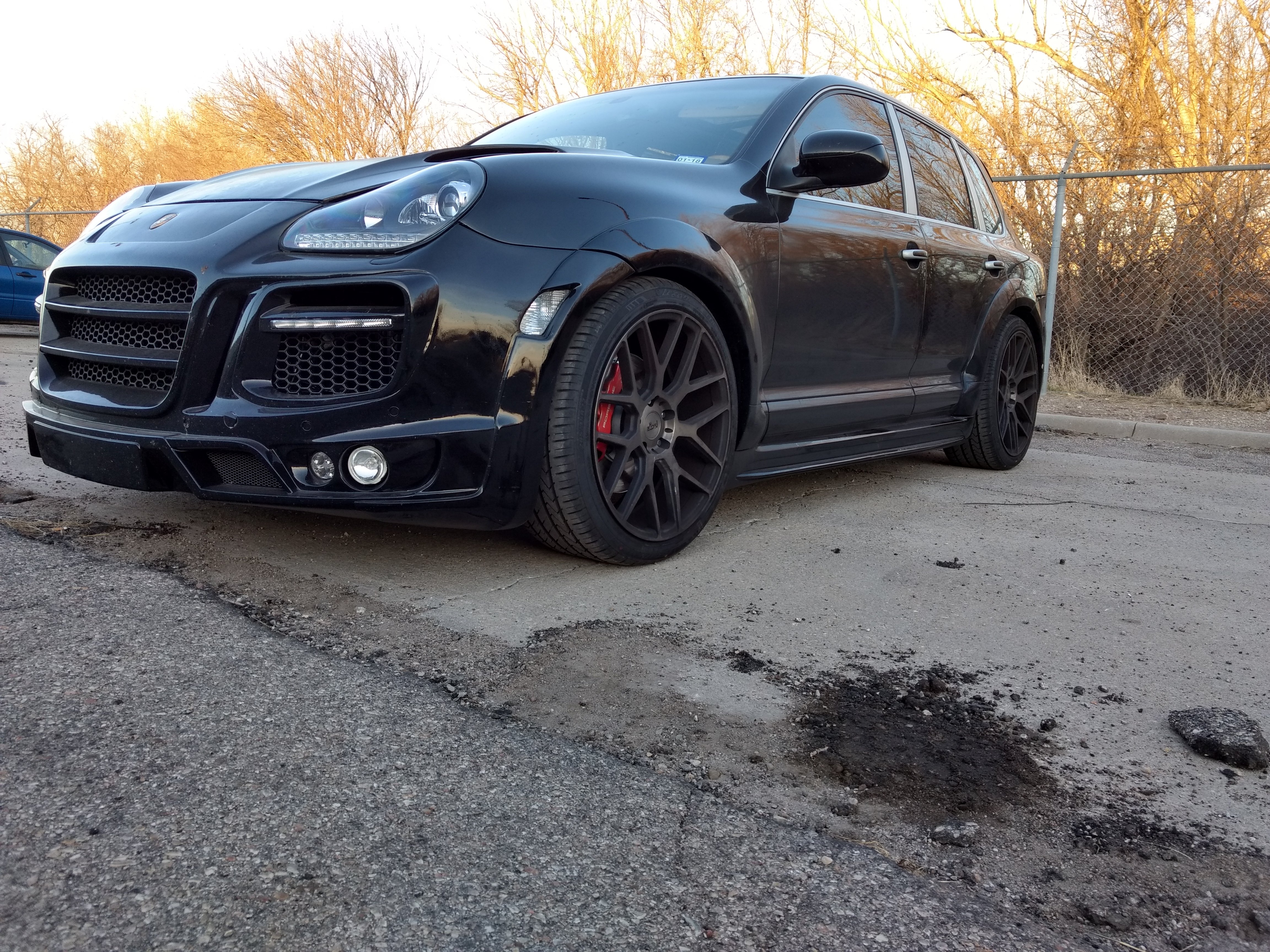

2006 Porsche cayenne turbo s. I had it with air suspension error (Orange), but it was still working. During the trip across country (from Miami to Kansas, if that matters), red fault "Check Air Suspension" showed up and stays there all the time. Plug\unplug battery don't work. The car stucked in medium position. Today i went to work on my car in workshop, removed the compressor and during removal let all the air out. I checked the voltage on power cable - nothing. I threw a jump wire from car battery to pump - it starter to work. I checked the cable with 4 pins ( i guess it's control unit) it showed 4 and 3.8 volts on each pair, which if i am not mistaken is not enough.
I don't know how to troubleshoot further, but my stupidity lowered the car to the bottom. The car jumps on road as a wild frog. I'm not sure if it's wiring or control unit. Does any one have a hint or a wiring diagram? fuses or any other common issues? Please help me, i can't drive my car and have no idea how to diagnose it. The nearest dealership is like 350 miles away.

There are also a lot of warnings against lowering the vehicle with all the air out of the air-springs, that "folds" can form in the air-spring bags causing early/premature failure of them. If you can get the compressor working - I'd suggest finding some way of lifting the car as the airbags fill with air - so the folds can unfold without a lot of force on them. I can imagine this is a problem since the car is SO low that even getting 4 jacks under it will be a challenge. Harbor Freight has inexpensive jacks - 1.5 ton ones should be adequate - but you'd need 4 of them (meaning you'd have 6 ton lifting capacity total.)
As low as the P!G is - it would be difficult to impossible to get it up on a flatbed trailer without damaging something, due to the angle of the ramp for the trailer.
