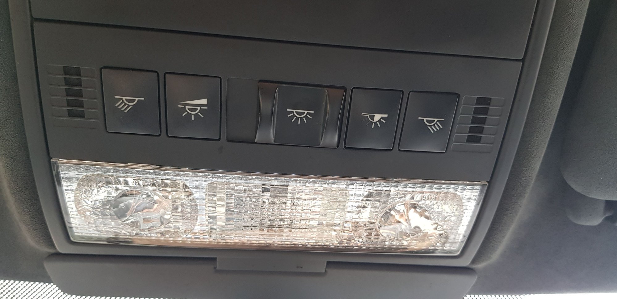

I included a picture of my rooftop ambient light buttons, they are the same as yours, but I believe with different function.
-the button you circled blue, takes care of dimming drivers side, the one you circled red, does the passenger side.
I like the idea of having ambient light in that gap, and if tonight I cannot find a way to activate them, I will use that gaps for blue led ambient lights, I still have(See picture)
Will report tonight about my findings..
Same buttons, but different function?

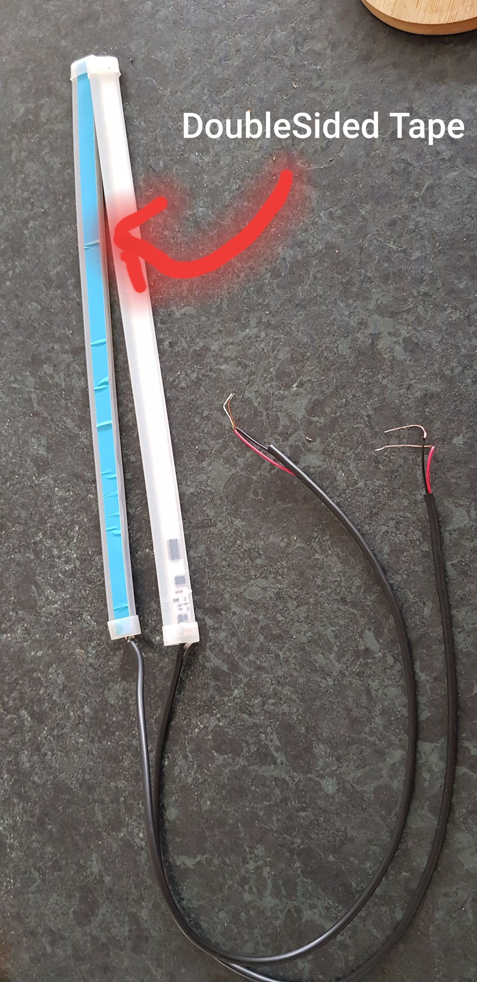

Those would fit in exactly in that gap, and a 12v source is close.
