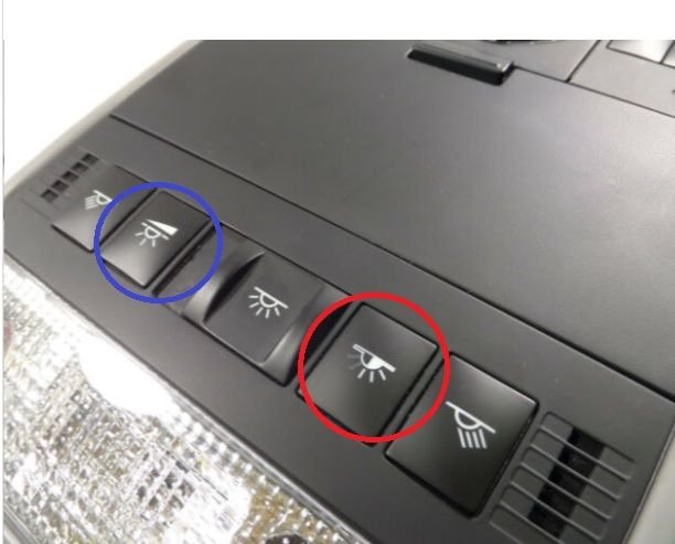

Sorry for the delay, so this isnt from my actual vehicle, but it was a good picture, and it is exactly the same:
Circled in blue is the button that you can continue to press till you get the desired brightness level, once you hit max brightness, it then starts to get dimmer with more presses, till it turns off.
In red is the button to turn the ambient lights completely on and off.
Now I cant say for sure how the door armrest ones work, as I cant remember since mine no longer work, and I always had them on and at max brightness, but I recall them working with the buttons I mentioned above, dimmable and could be turned on/off.
The footwell lights work with these switches as well.

So I have the button in the red, but not the blue. The red button only seems to switch a relay and the only thing I can see come on or off at night is the lower center console light.. nothing else..
Thoughts? I'm in the Everett/Seattle WA area and current;y don't have access to a VCDS.. Not sure if mine even came equipped with the ambient light package....
