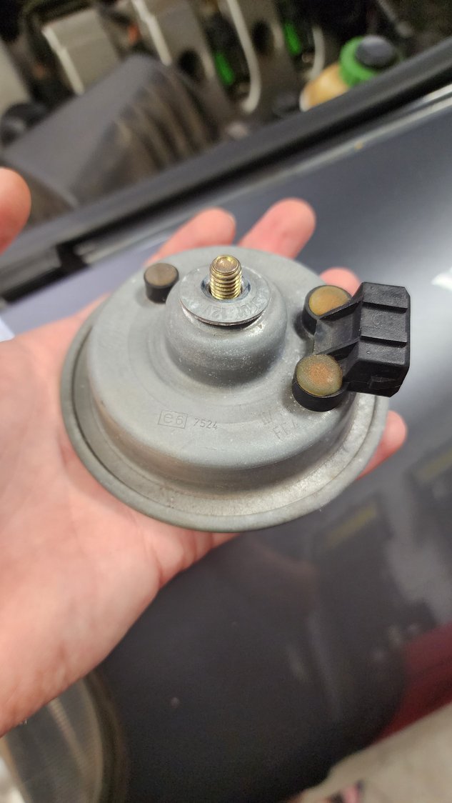

I figured it would be worth a shot trying to replace the alarm/siren module since it wasnt too expensive and seemed like a likely culprit. I ordered the alarm module and went to install it tonight but was surprised when it wasn't in it's usual location. On the 955, it's normally underneath of the fuse box on the driver's side (should be part number 95561823702) but instead I found 95563711702 in it's spot. Part # 11702 is a circular metal horn with a wire going into it.

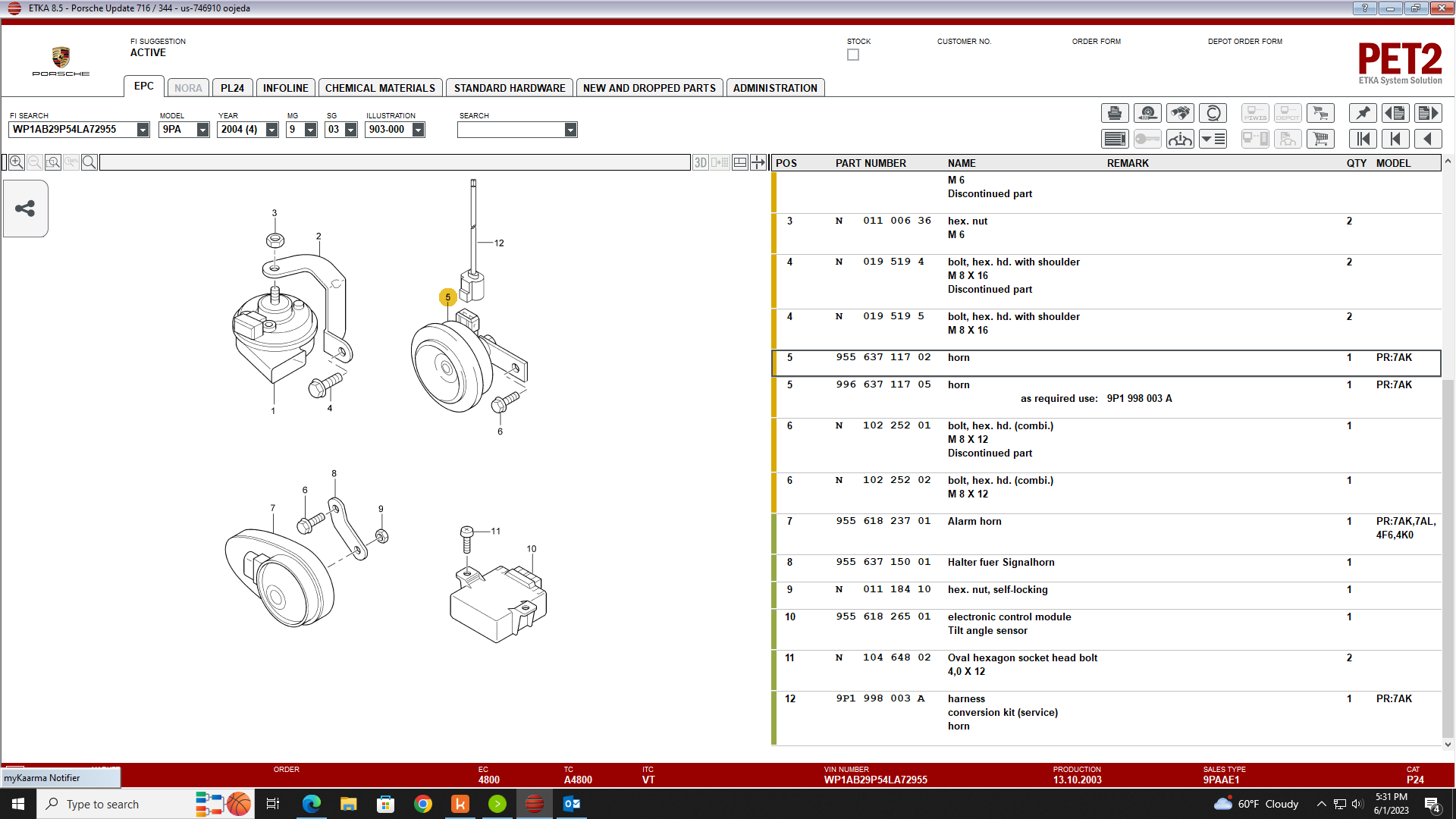

I called two Porsche dealerships with my VIN # and they said that my VIN # shows that I have both alarm modules/horns on my Cayenne (95561823702 and 95563711702).
None of their diagrams show the location of part number 95561823702 though?

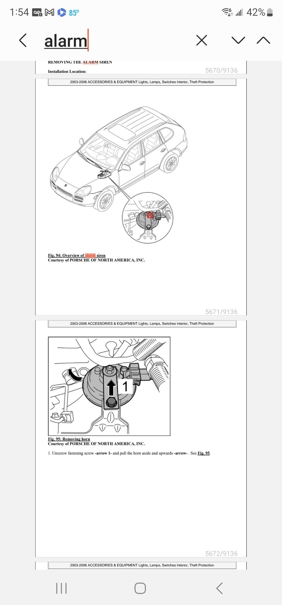

Just updating this post in case anyone in the future has this problem. The service manual shows exactly the same thing that I found in my Cayenne. A metal circular horn located underneath of the fuse box on the driver's side. The service manual makes no mention of the other part being anywhere in the vehicle. However, two different dealerships that I talked with are insistent that I have both pieces in my Cayenne going off the the VIN # and database but no one knows exactly where it's located.
