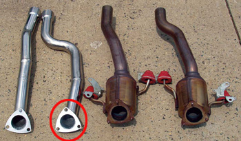

I just received bypass pipe today and got so excited.
However, Porsche dealer called me and let me checked the problem area.
According to Fabspeed, it's direct bolt-on application. However, the fitment of bypass was way off from factory holes. Also, the triangle plate didn't match at all.
Is spec. any different between 'turbo' and 'S'?
In my understanding...NO.
I'm going to ship this back to Fabspeed tomorrow and get a new set that works on mine.
Any trouble shooting to any1? or is it just me or any suggestions?
Thanks in advance.

The turbo bypass and NA bypass pipes are not the same and completely different in length, bends, ect...It is direct bolt on if you bought the right ones...

They sent me the right parts but actual product didn't fit at all cause the flange was up side down.
No way of doing bolt on and off. (Is this happened to me only?)
So, our mechanic did some custom work and installed today.
I wasn't happy with the application of product and quality but the result was goooood.

make sure they didnt send you two rights. They did that to me, and although it seemed like it may fit, it didnt, and they had to send me a left side as well. They looked almost the same, just a tad off. That is more than likely the problem.

renntech36 - They sent me 2 different pipes. It was not a same pair.

yes...and as I have stated the S pipes are not the same as the turbo pipes. From Joe's fabspeed site.
S version:
Turbo version...they don't look the same to me....

You are Fabsolutely right.
'S' and 'tt' is different.
Also, they sent me right pipe EXECPT, one of pipe's flenge was upside down where you can not bolt-on to stock pipe!
I don't know if they sent me the wrong one or what?
I just didn't want to wait and my mechanic had to cut out the stock's flenge put them on Fabspped one.
It sounds odd...I wish Fabspeed check their product before they ship out.
Just to pay Xtra installation fee bothered me a bit but I like the result.
Oh! can Fabspeed pay my extra installation fee?
Eric
***red circle was problem. it wasn't just little off. it was totally upside down.
