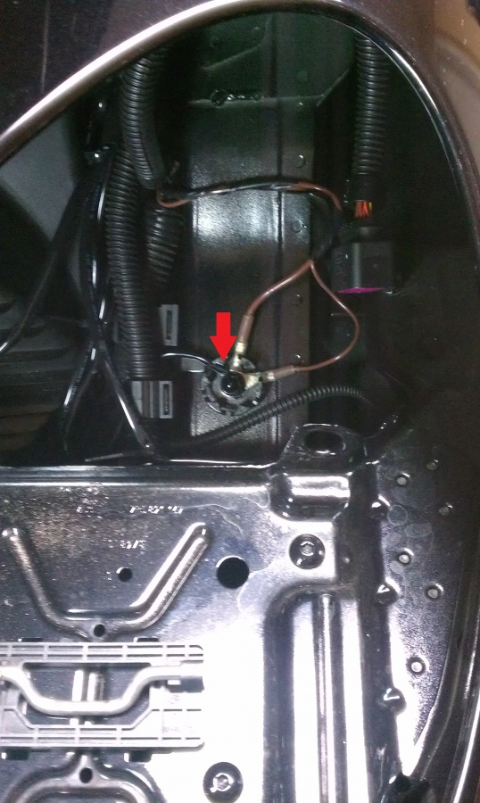

Remove the headlight you will see the grounding connection.
You can run the positive side wiring inside the driver side fender.
To connect the passenger side ballast and oem connection, remove the center trim panel covering the radiator and run it along the radiator.
Nice clean install and the relay harness completely hidden.
