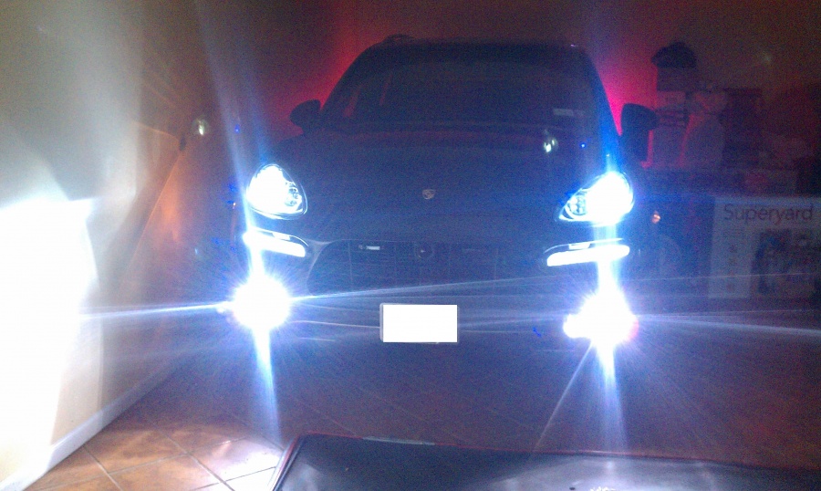

Finally completed the HID foglights conversion.
H11 5000k for fog lights
D1S 5000k low beam
H7 5000k high beam (must use a special adaptor to secure the HID bulbs in place)
The color from the 5000k matches the led lights perfectly.

Very hard to take pictures with a cheap camera phone.
