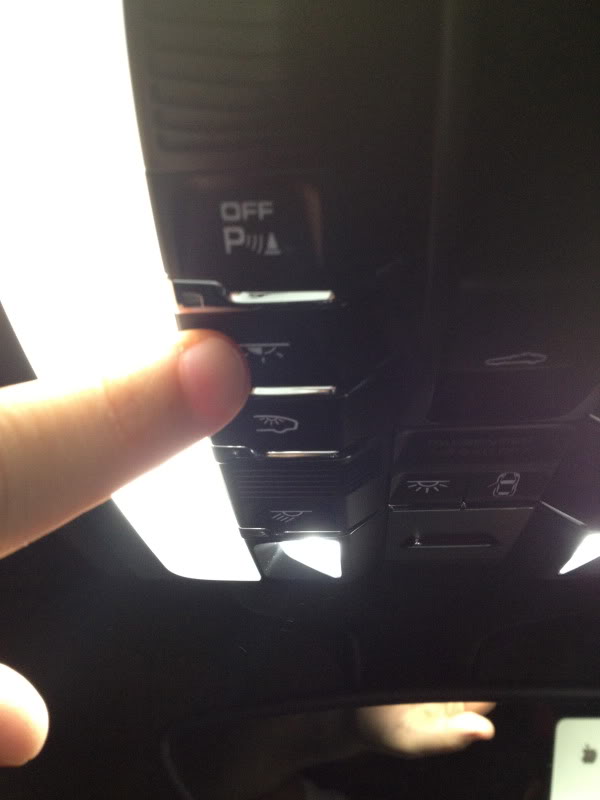

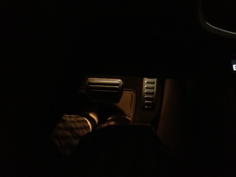

Yes it saves the settings.
This is what I did, I waited till it was dark and started the car and the headlamps were on, after the initial entry lighting goes out turn on the interior lights then hold the button till it dims to your desired level.
Once set save the settings with the memory package next to the door handle. Remember to use the same key if you lock the car afterwards.
Then next time it is dark when you unlock the car and open the door, yes it will be full entry bright, then after you start the car and headlamps are on the desired ambient lighting will be on inside the cabin.
Button to push and full entry lighting.
Set ambient lighting, and yes I'm still in my pajamas and socks!!!
