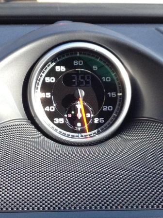

Well I got my clock replaced at the dealership today. They told me that there is an issue with the original vendor and the clocks in the 2013 MY. They replaced it with an "upgraded" stopwatch style clock that looks totally different. I'm not sure if I like it more or less than the old style, but it is growing on me. They told me this is an $600 part...I should've asked if they could replace it with the dash compass, since I'm sure that's probably what the compass costs.
Is that a photo of the old or the replacement clock?
EDIT: never mind, I see the label on the face is different.
Old Sep 14, 2012 | 10:31 AM
  #29
Mr.Brightside's Avatar
Joined: Aug 2012
Posts: 16
From: Chicago
Mr.Brightside is infamous around these parts
Originally Posted by steph280
Is that a photo of the old or the replacement clock? Looks exactly like the ones in 2012's.
The picture I posted is the new replacement. The old one they replaced is the one in the video in the first post of this thread. One odd thing I did notice about the new clock. The setting to illuminate the clock has to be checked for the clock to function. Before that was not the case.
