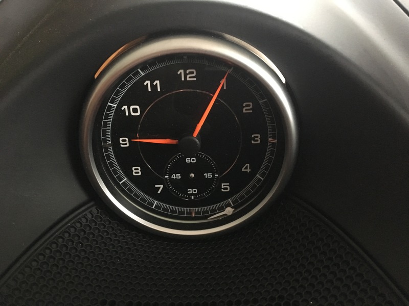

Thanks so much to deilenberger for the how to on making this fix below are some pics for other users:
The problem

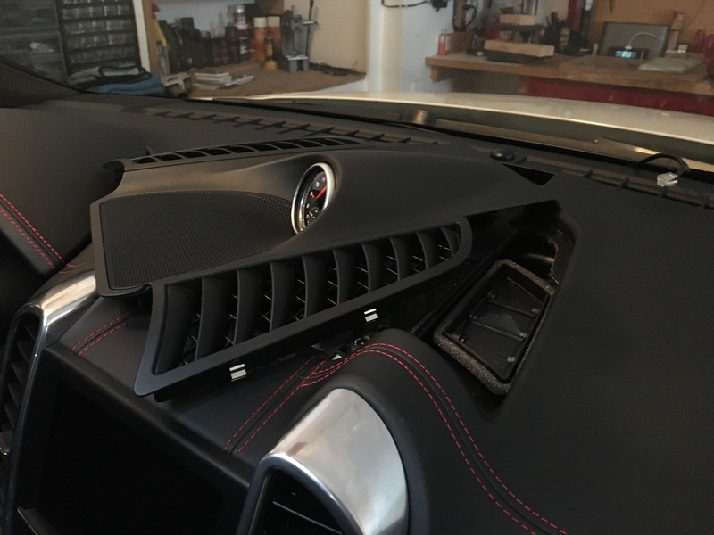

-Stick fingers into the vent on the passengers side of the center top dash panel, gently pull up a bit and the clips center on that side should be released. Repeat on the driver side. No tools were necessary. the dash gave up the center section by gently pulling on the vents

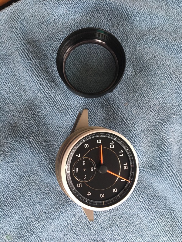

- Hold body of the clock in your right hand - facing your left hand. Grasp the silver bezel with your left hand and turn anti-clockwise. It will unscrew.

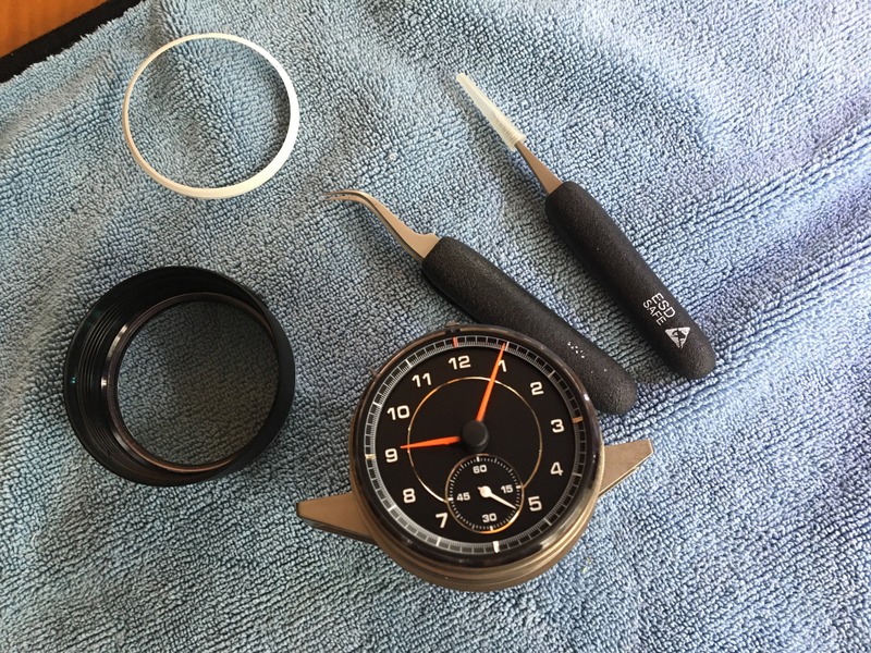

- Remove the white lighting ring it lifts out.
- Tiny (toothpick end size) dab of adhesive on the on the end of the second-hand shaft. I used a fast setting craft adhesive designed for jewelry making. My girlfriend is a crafter so I had this adhesive handy.
- Place the second hand back on the pin with a pair of tweezers then using gentle finger pressure - push the second hand back on the shaft. The second hand is fragile so be carful
I let the adhesive set up for a few hours. only use the smallest amount of adhesive.
resemble the dash in its entirety Good to go you saved yourself $$$

Sorry I wasn't as clear as I'd hoped - all the center vents, with clock, without clock, Boze, Burmester, whatever are one piece. It's held down with two clips on each side of the vents, then two clips in the rear of the center piece, and two clips on the front of the center piece.
And the pics are a great addition to the thread! Thanks!
