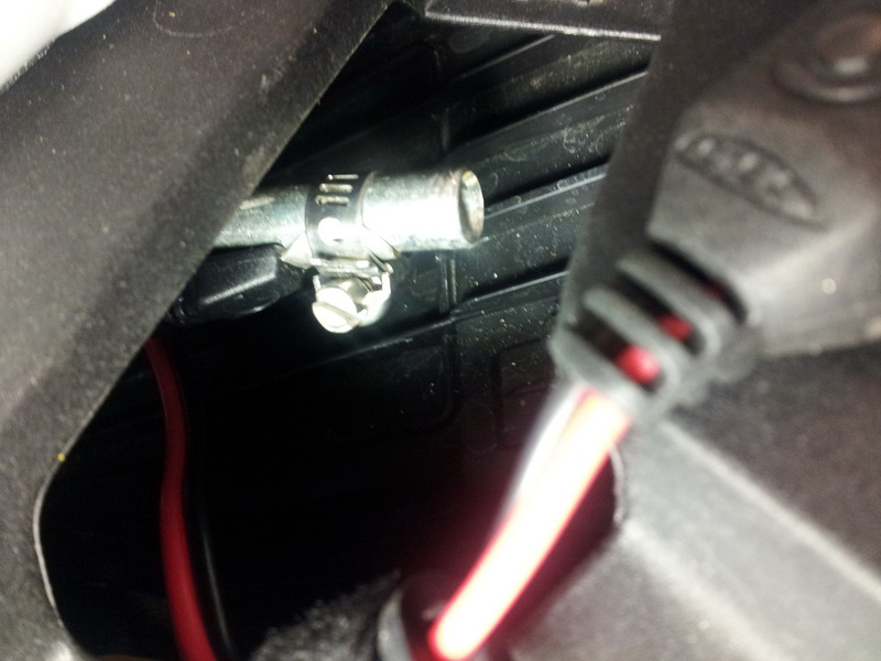

Install of CTEK US 4.3

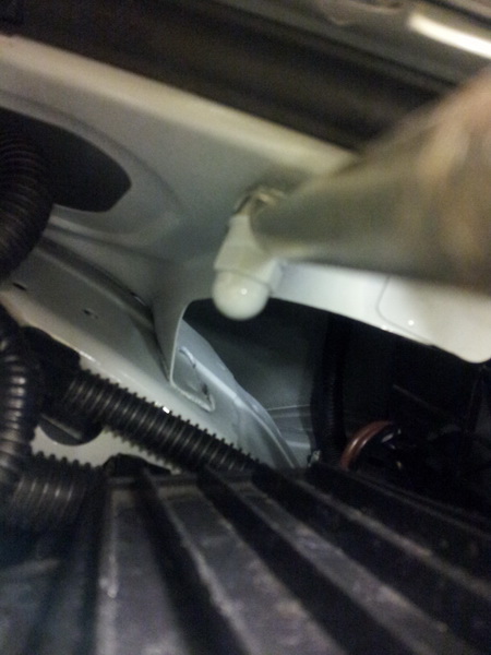

I received the charger and installed it tonight. I'm happy with install but wonder if anyone has any better idea. I didn't drill any holes or modify car so I can undo it if a better idea comes along.

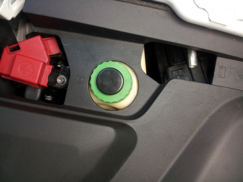

First picture is what it looks like under the hood. Red cover hides 3 "+" connectors including one big round post. The negative pipe can be seen just forward sticking out. It is simply a conductive pipe attached to the frame. I stuck the camera inside to show how the white acorn nut holds it to the frame.
Also one picture shows a closeup of my use of a stainless steel small hose clamp to hold the "-" connector to the ground pipe still leaving pipe to clam onto if necessary.

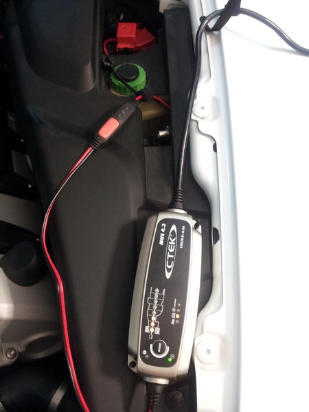

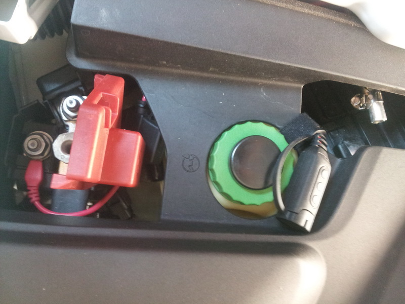

The next picture is everything connected with the small "comfort monitor/indicator" flashing the existing charge level of the battery.
Then I connected the charger and took a couple pictures showing it at stage 3 out of 8.
Finally a picture of the nice bag that comes with the charger--reinforcing that you connect the DC before the AC, then set the mode.

Looks good! That will do the trick. Good job.
