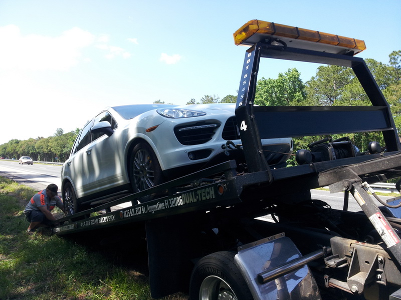

On way home, south of Jacksonville, coolant temperature warning. Pulled to side of road I95 immediately. Lifted hood, coolant red color all over engine and hood. Waiting for flatbed. Approx 1820 miles since engine replaced. Total 8317 miles on car.

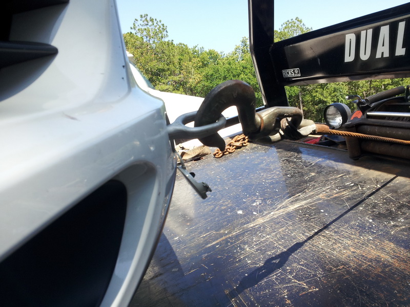

Exactly right. Appears hose was slid onto the fitting but the clamp wasn't slid up over the end and fastened. Came off on I95 in heat of day.
note: As you can see I used tow fitting in trunk. Everyone note there is only one tow fitting in the tool kit. The molded foam has room for two. Tow driver said he wouldn't pull it up without two. Later his boss and the Porsche dealer confirmed it only came with one and it was OK. Regardless I picked up one ($33) at Brumos Porsche where it was towed and fixed and washed down. I suggest to make Murphy's law work for you and get the second tow ring.
