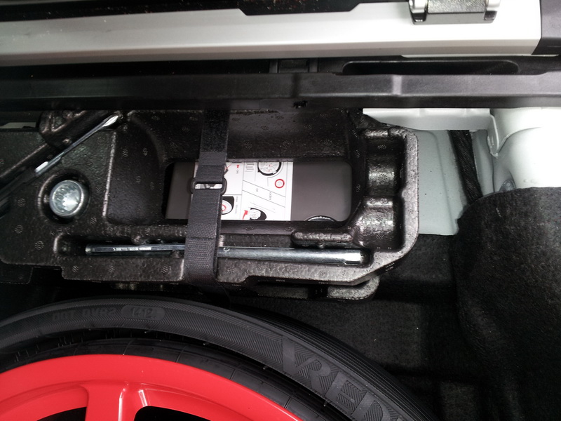

I noticed that there is a video "tire resealing" that explains how to use the little resealing liquid container that "should" be in the spare tire compartment of your Cayenne. I noticed that there was one in the Panamera loaner that I had but when I got my Cayenne back, I saw the place for it above the little air compressor with a velcro holder strap but it was not there. I don't believe it came with my car. I'd be curious to know if others have that little kit.
Kit is shown here: http://www.suncoastparts.com/product...e=958v8TTEngMK

An earlier thread dealt with this
Sealer only comes with hybrid or diesel...I forget which.
In any event no sealer provided with collapsible spare.
I went ahead and got a bottle from Suncoast and put it in the slot

Ah. Thanks. Crazy between the kit and the bag it's $90. The Panamera loaner was a hybrid and there was one inside so it's likely those. Here's a picture of where the sealant kit fits for those who may be wondering.
