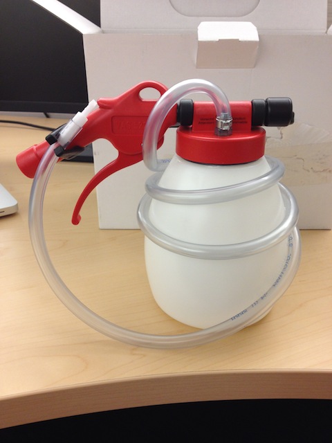

The extractor I mentioned is the shop tool to extract the water out of the filter housing. The VW parts guy had to ask a tech about it who confirmed what the tool part number was (which I had already given him and in fact showed him the relevant tech page) but said they don't bother to use it in the shop. I'll use the extractor though as it will hopefully be less messy and I don't want to give PCNA any ammunition if questions arise down the road.

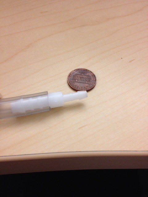

Is the extractor tool you mention a Porsche/VW/Audi specific one or can a generic one be used as well? Can you post a pic of this tool?
All I have is the is the "stick figure" drawing in the manual (this link shows a version of the image from a Golf TDI guide, the Porsche version looks better ). Once I have one I'll of course post a pic.
As the VW guy said the techs at that dealer don't even bother with it I assume it's not really needed or can be improvised, but I'll know better once I get it and perform the service. Of course since I'll have the tool I won't need to improvise it, but I'll be happy to provide my opinions and any helpful information to those that want to.
I'd call it a glorified brake bleeder. Doesn't appear to be any reason that a MityVac or similar wouldn't work just fine.

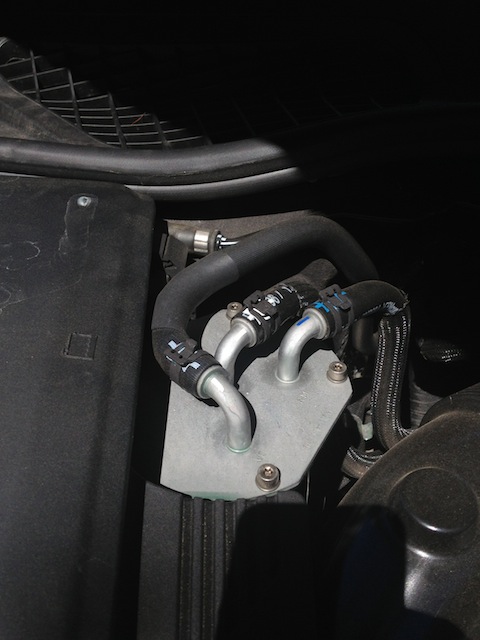

For anyone interested, here are some shots of the filter housing with and without the plastic shield removed. The housing is located on the passenger side up against the firewall and is clearly visible.
Removing the shield is easy enough. There are just three plastic trim "bolts" (don't know what they are called). There is a piece in the center of them that you pry up and then pull the whole thing out. After they are out you can then remove the shield. It's probably a bit easier if you remove the front shield, but I didn't have to do that (the driver side shield was a much bigger PITA, but I still didn't have to remove the front shield).
You do have to remove the plastic shield to get to all the bolts off. If you look at the pic without the cover you can see a tube that runs on the left side over the housing. It covers a bolt and you can't move the tube with the plastic shield in place.
You might also notice on the right side of the housing cover that I apparently have a friend that has been visiting The air filter (also under the same plastic cover, but it's up front) looks good and I don't see any signs of damage anywhere else.

My guy finally got around to getting the tool to me. Here are some live pics for reference.
