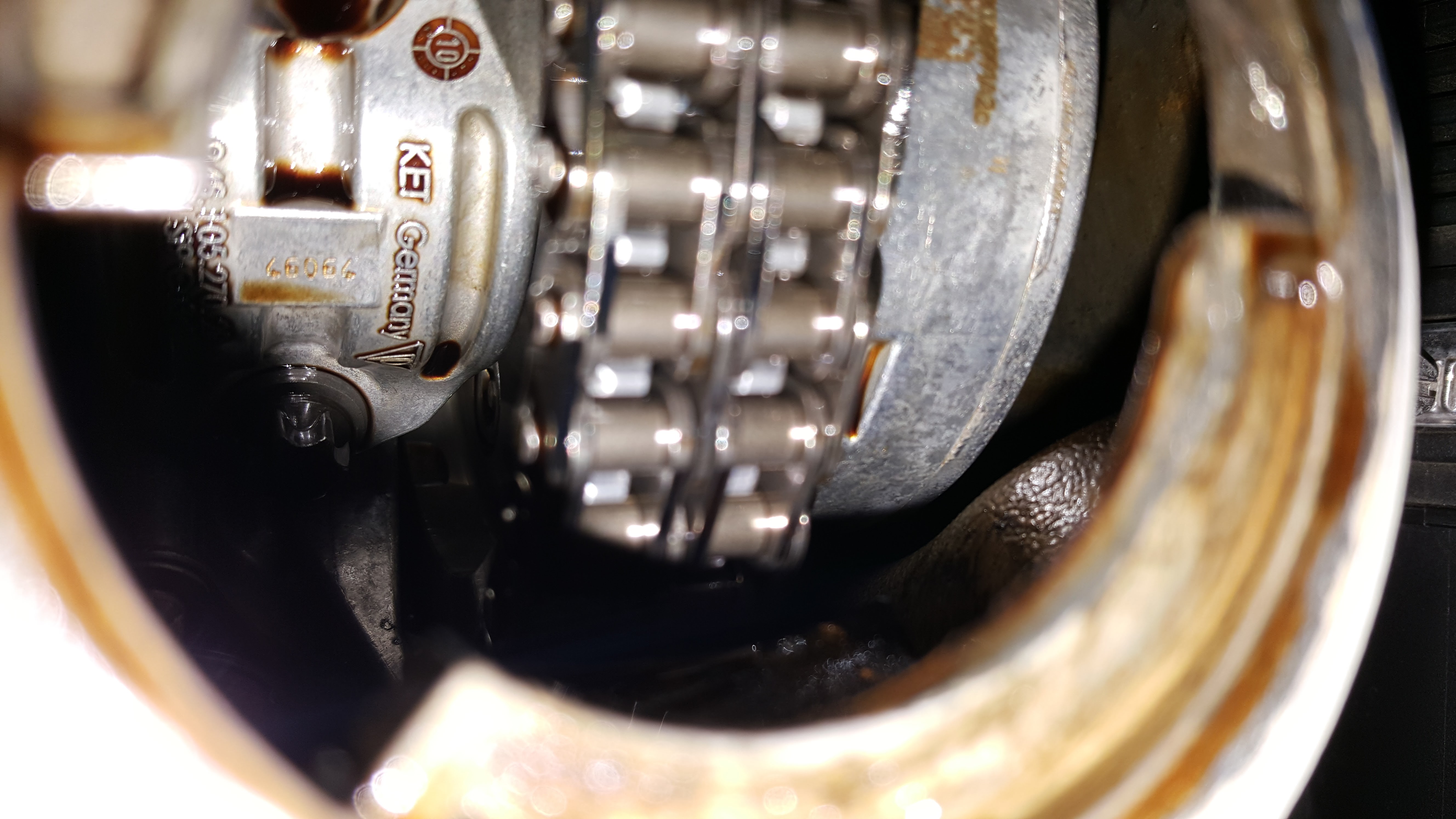

I checked my camshaft adjuster after opening the oil seems like mine has no part number is that possible???
I wanna get this done under warranty before it ends..

Is it possible the part # was facing down? The number is on a rotating part. If you look at the bolts it's very easy to tell if yours are the good or bad ones.
I also doubt that any warranty will cover it unless it actually fails.

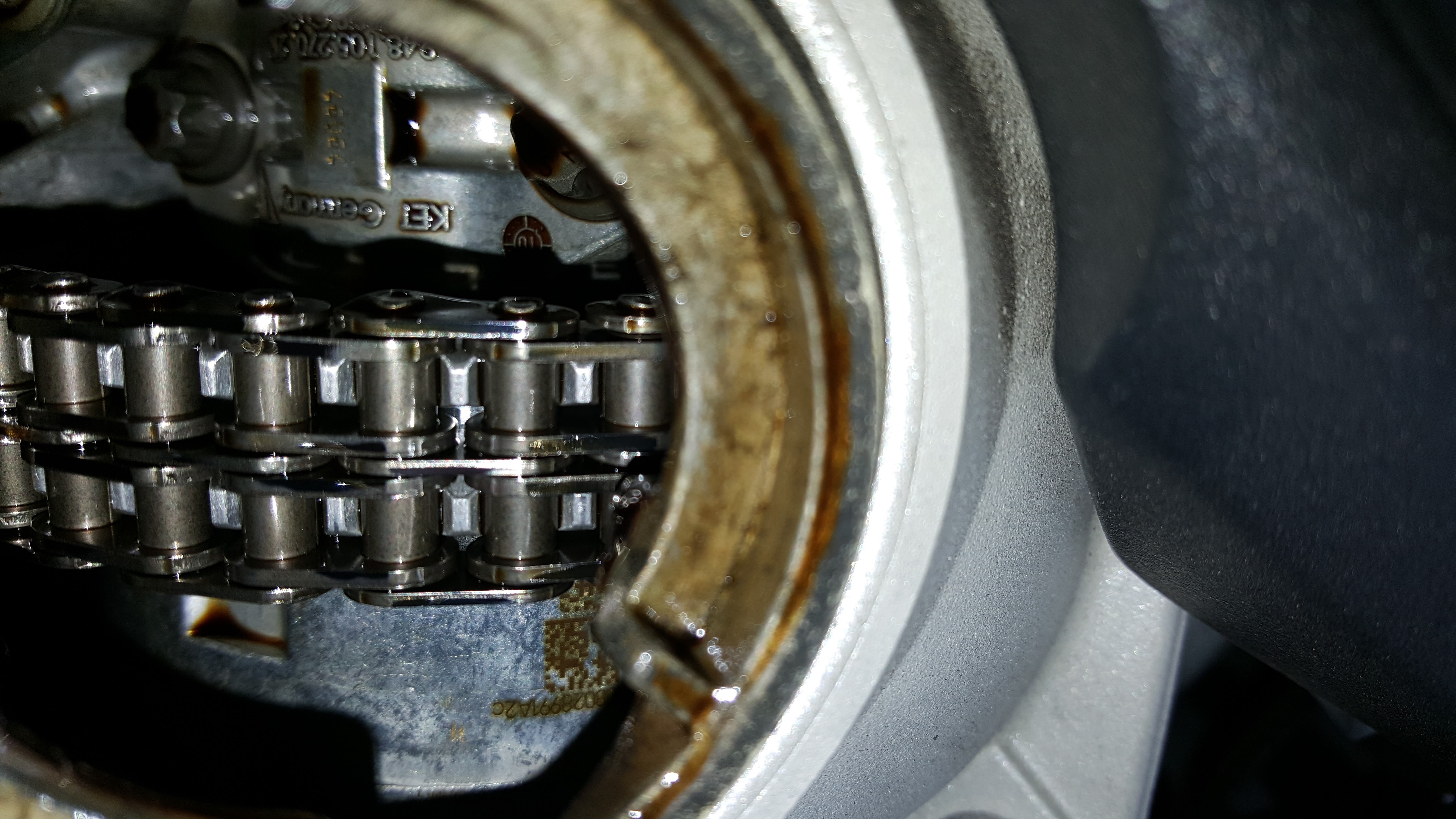

I have the same issue. Could not find the Part Number. Here are some pics. There is some sort of Part Number (in the rusted yellow at the bottom of the second pic) but it does not appear to be a Porsche Number. Anyone have any ideas on this? my car has the "bad" bolts with the center stud.
Keep rotating the engine - there IS a stamped PN on it - probably facing down at the moment.

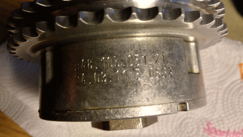

Old Variocam Adjuster
BTW - if your bolts have the center stud - you're unfortunately in the group with aluminum bolts. No need to see the PN.. you already know the bad news.
